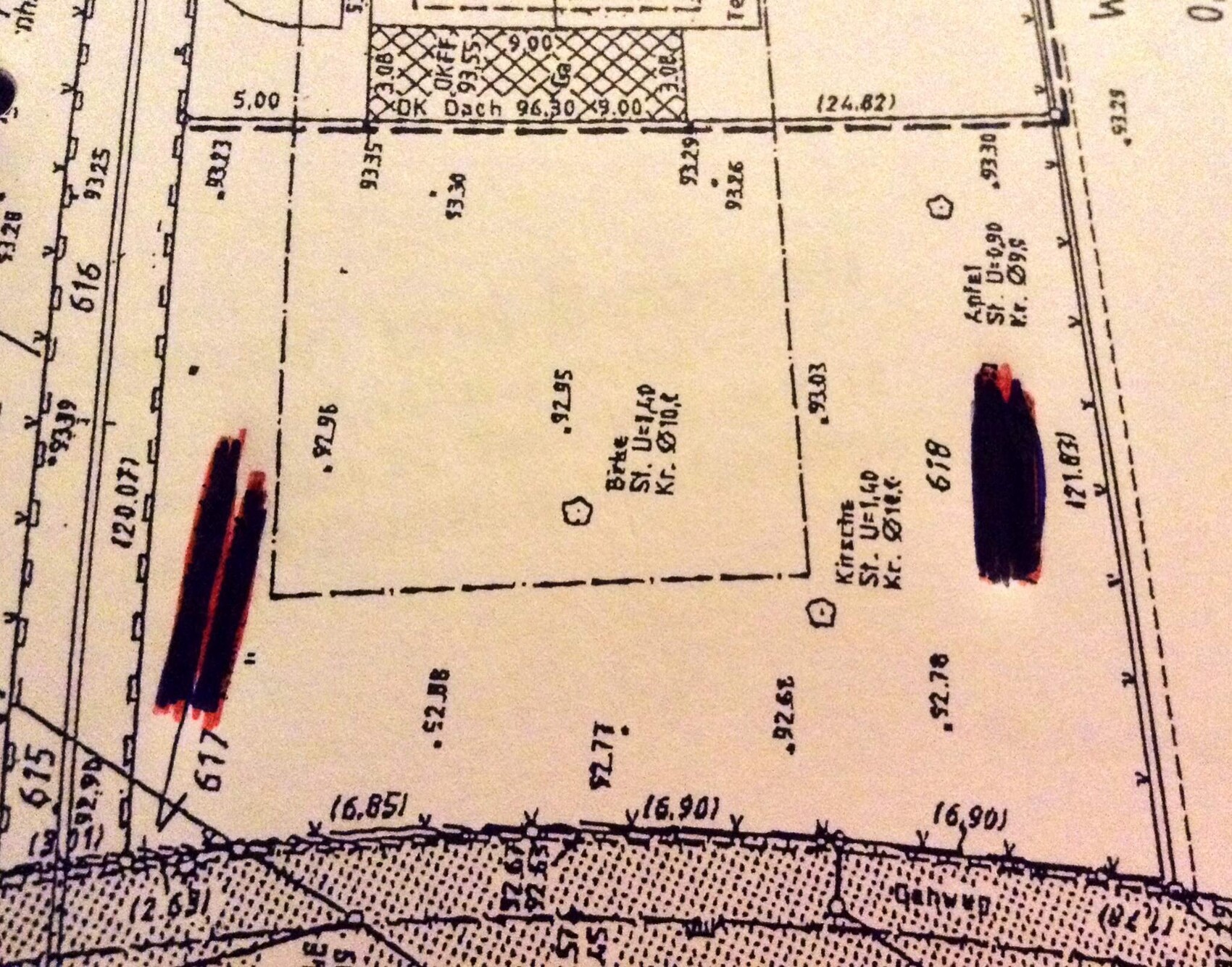

chaosandi14 May 2014 22:25At least one garage or carport, or similar structure, is usually allowed to be built directly on the property boundary. A site plan showing the property and neighboring plots would be helpful.
Oh, that’s possible too? Then I’ll have to dig out the building plans again; they are with the documents I received when I inherited the plot three years ago.
The building zone starts directly at the property line with the left neighbor and measures 13 x 13 m (43 x 43 ft). There are still 8 m (26 ft) to the right boundary.
But building right on the boundary wouldn’t be ideal, as it would place us even closer to the neighbor.
Thanks for the tip.
P.S.: A carport is planned, either a double carport or one on the left and one on the right side.
I’ll look for the documents and upload them here.
Thanks for the tip.
