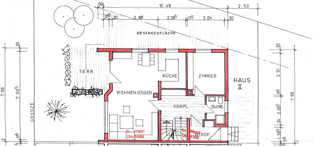

We are currently planning to remove the wall between the kitchen and the living/dining area. We hired a structural engineer who visited the site and examined the wall in its plastered state. He also received the plans (see attached floor plans). Interestingly, the wall was built continuously, contrary to the construction plans. Unfortunately, no structural documents are available.

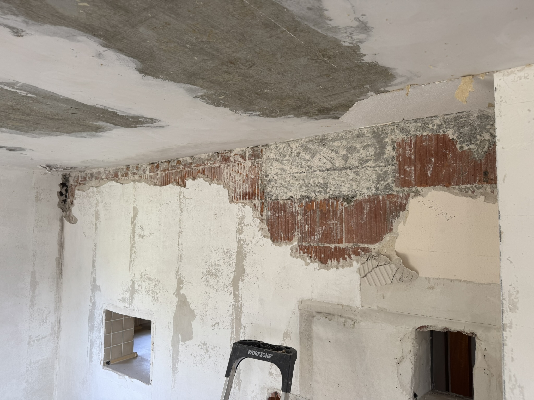

Unfortunately, the cooperation with the structural engineer has been somewhat "odd." He has now asked me to expose the wall connection (why?). I did so, and the following structure was revealed. It looks somewhat unusual to me as a layperson, but maybe there are experts here who can assess it better. The gray block looked like concrete, and some reinforcement was visible. The other holes in the wall are the former pass-through and "heat channels" for the wood stove, which has already been removed. The (visible) remaining part was built with bricks.
I am now wondering why the engineer wants pictures and if it wouldn’t be possible to simply calculate everything on the computer. Is this a usual practice? And what do the experts here think about this wall structure?
