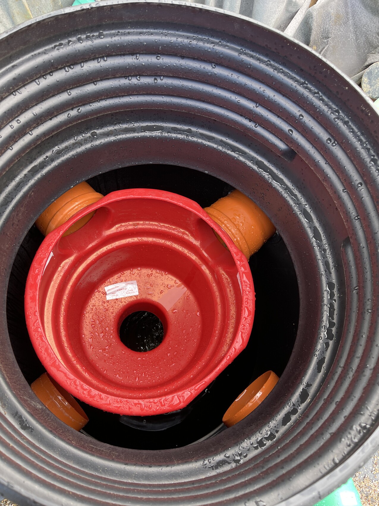

I don’t have a flat tank, but I suspect the bottom is not completely level.
What kind of pump do you have now? A floating suction?
You can also hang the pump on a rope or chain to keep it upright.
Pumping directly from the bottom is not ideal anyway, as you might draw sediments into your water system…
