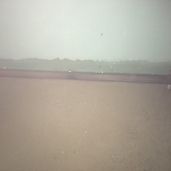

In our new build, water from the neighboring construction site repeatedly enters our basement. The adjacent house is still partially unfinished. After the basement was dried out again, drywall panels were installed. Due to ongoing rain, the water level in the basement is about 5 cm (2 inches) high again, and the drywall is slowly absorbing water. Is it possible to dry them out with construction dehumidifiers, or do they need to be removed?

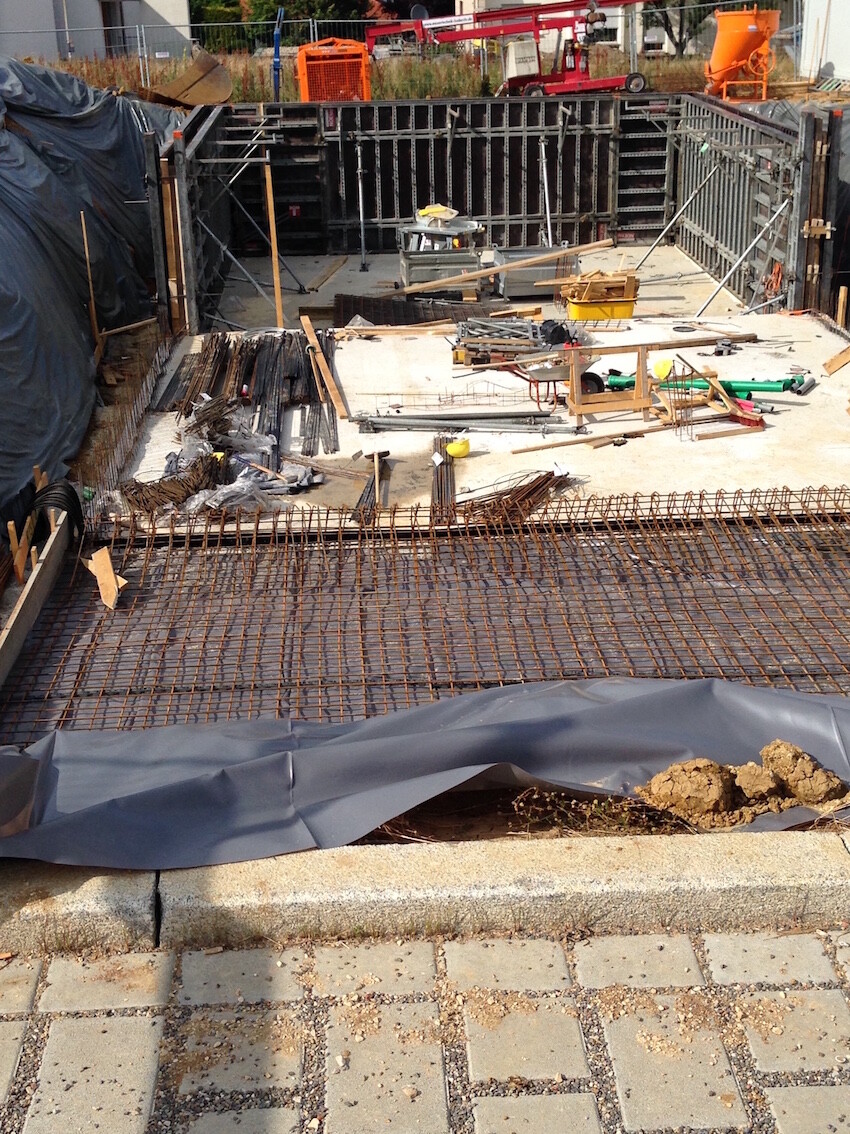

I assume that it comes from the neighbor. Since we have a shared foundation slab at a different height, water will find its way.

23 Apr 2016 17:36
Take a look at the picture.
