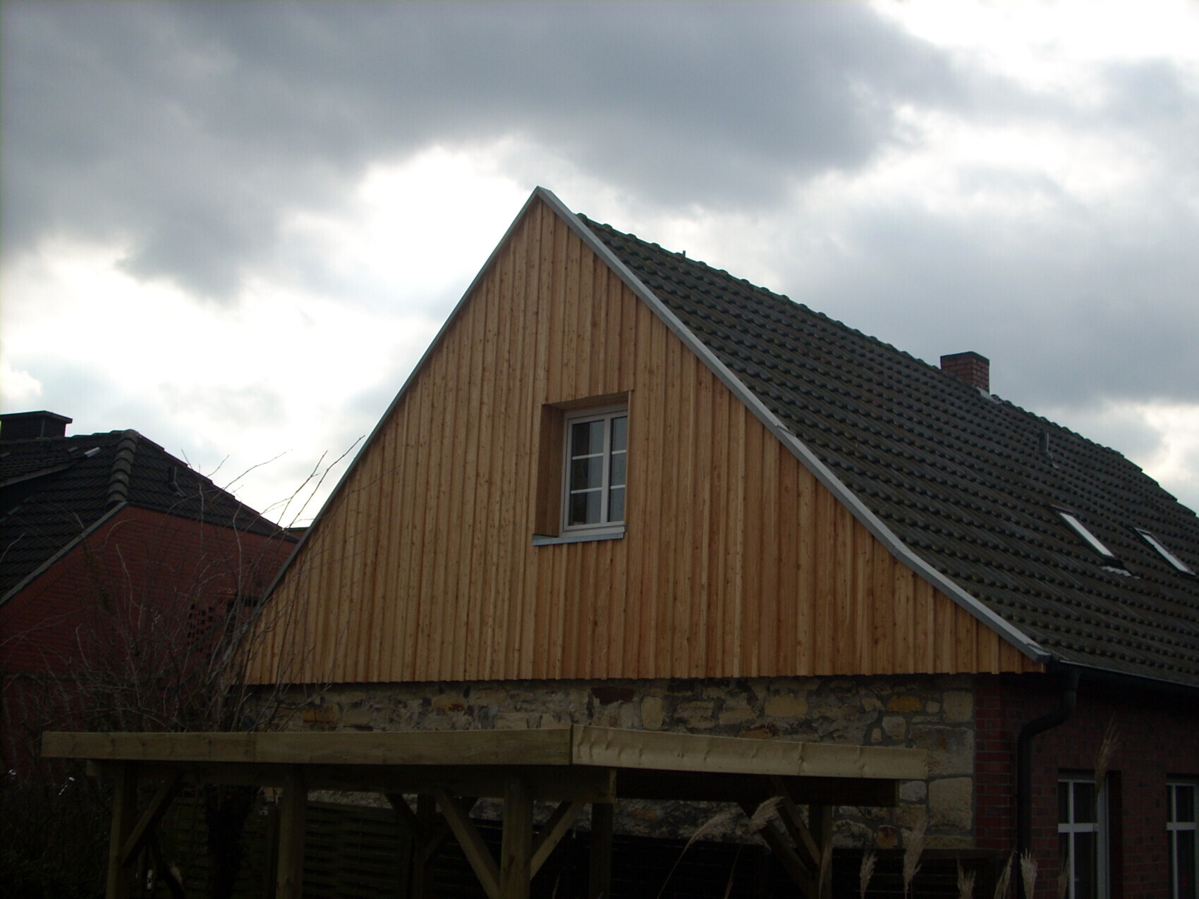

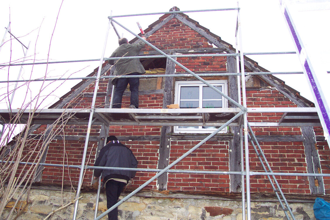

knalltüte15 Mar 2021 22:39Curtain Wall Facade (Renovation) Gable with 6cm (2.4 inches) Wood Fiber Insulation Board + Larch as Bottom/Top Cladding:
Costs approx. 4K in 2008 (done by craftsmen from family)
Afterwards:
This is how it looked before:

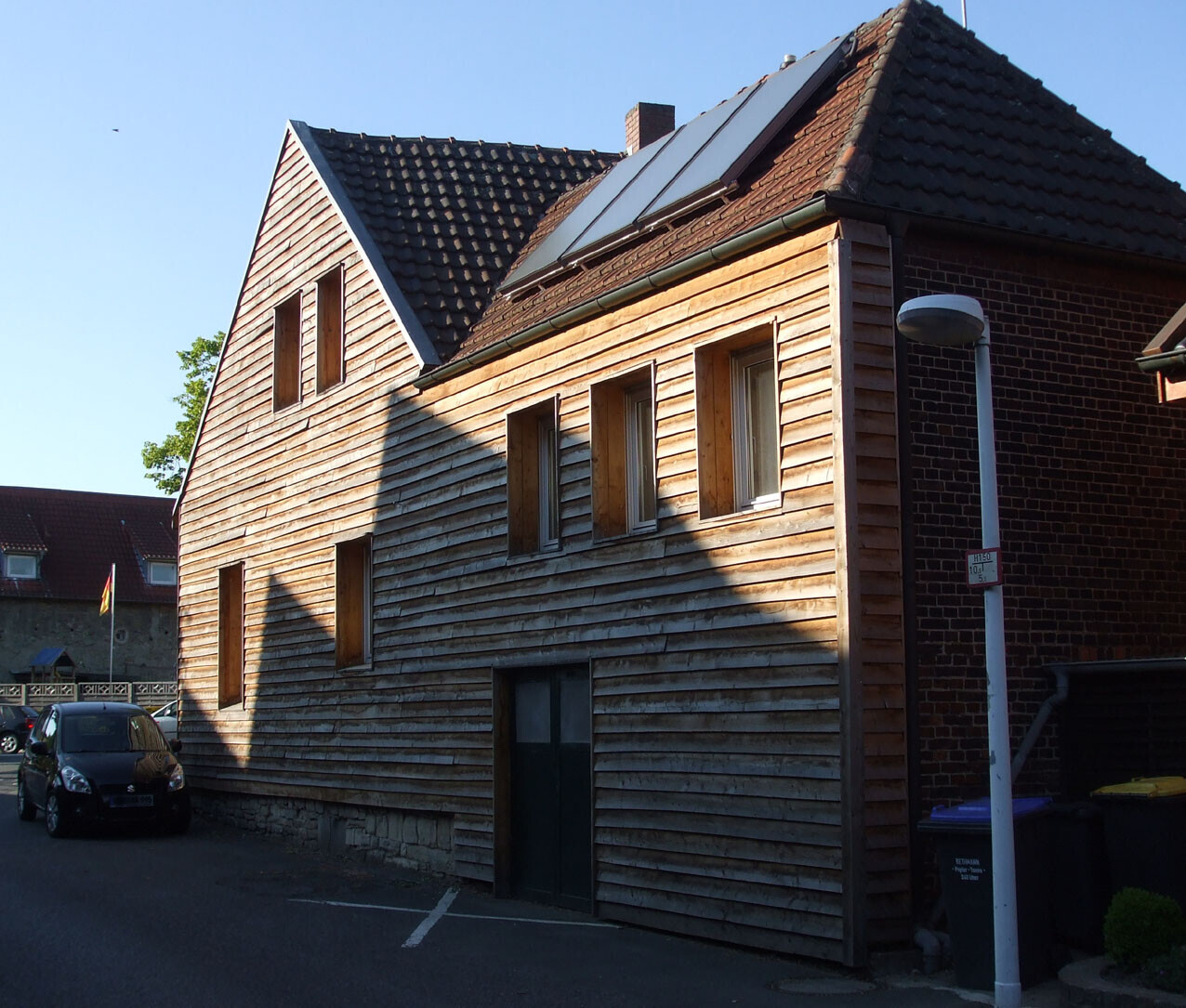

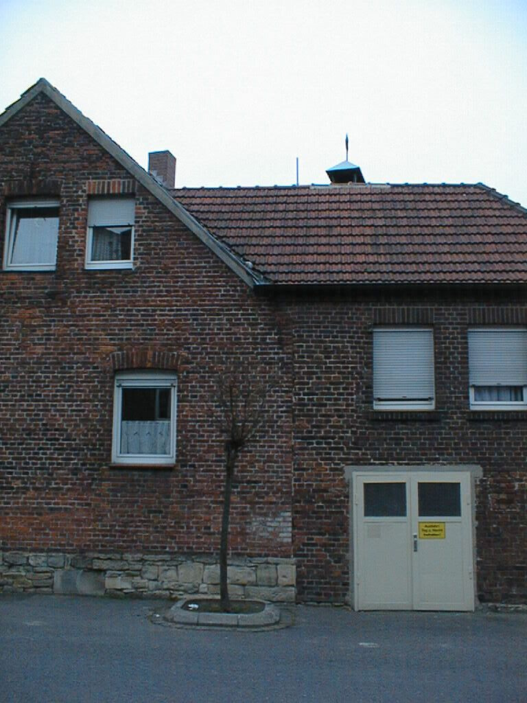

A bit later (about 1.5 years) the facade on the other side with about 100m² (1,076 sq ft):
Substructure of wooden beams, 10cm (4 inches) stone wool insulation, underlay membrane, larch clapboard siding. Almost everything done by myself with some help from family and friends (due to fear of heights :-( )
Costs: approx. 4-5K for materials (collected/traded from various sources due to limited budget)
Result:
Before it was rather awful:
It now looks somewhat different (weathered to gray), but I am still very satisfied.
However, I designed everything quite open (more than just vapor permeable) because I was afraid of risking the old materials by making too large changes and therefore sacrificed better insulation.

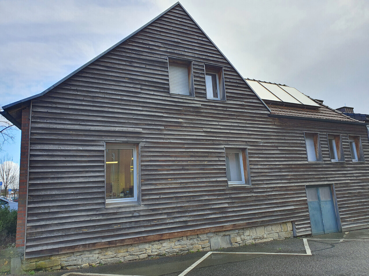

alterego13415 Mar 2021 22:43Many thanks! May I be a bit cheeky: do you perhaps still have a photo of the now weathered facade at the front?
That actually reminds me of one advantage of ventilated facades (VHF): the level of self-performed work is higher than with external thermal insulation composite systems (ETICS).
knalltüte15 Mar 2021 23:25alterego134 schrieb:
Many thanks! May I be cheeky: do you perhaps have a photo of the now weathered facade at the front?
That actually reminds me of one advantage of ventilated facade systems (VHF): the amount of self-contracted work can be higher than with external thermal insulation composite systems (ETICS).If I don’t forget, I’ll gladly share one. Otherwise, please remind me...Yes, that’s right—the amount of self-contracted work can indeed reach 100%, as you can see.
