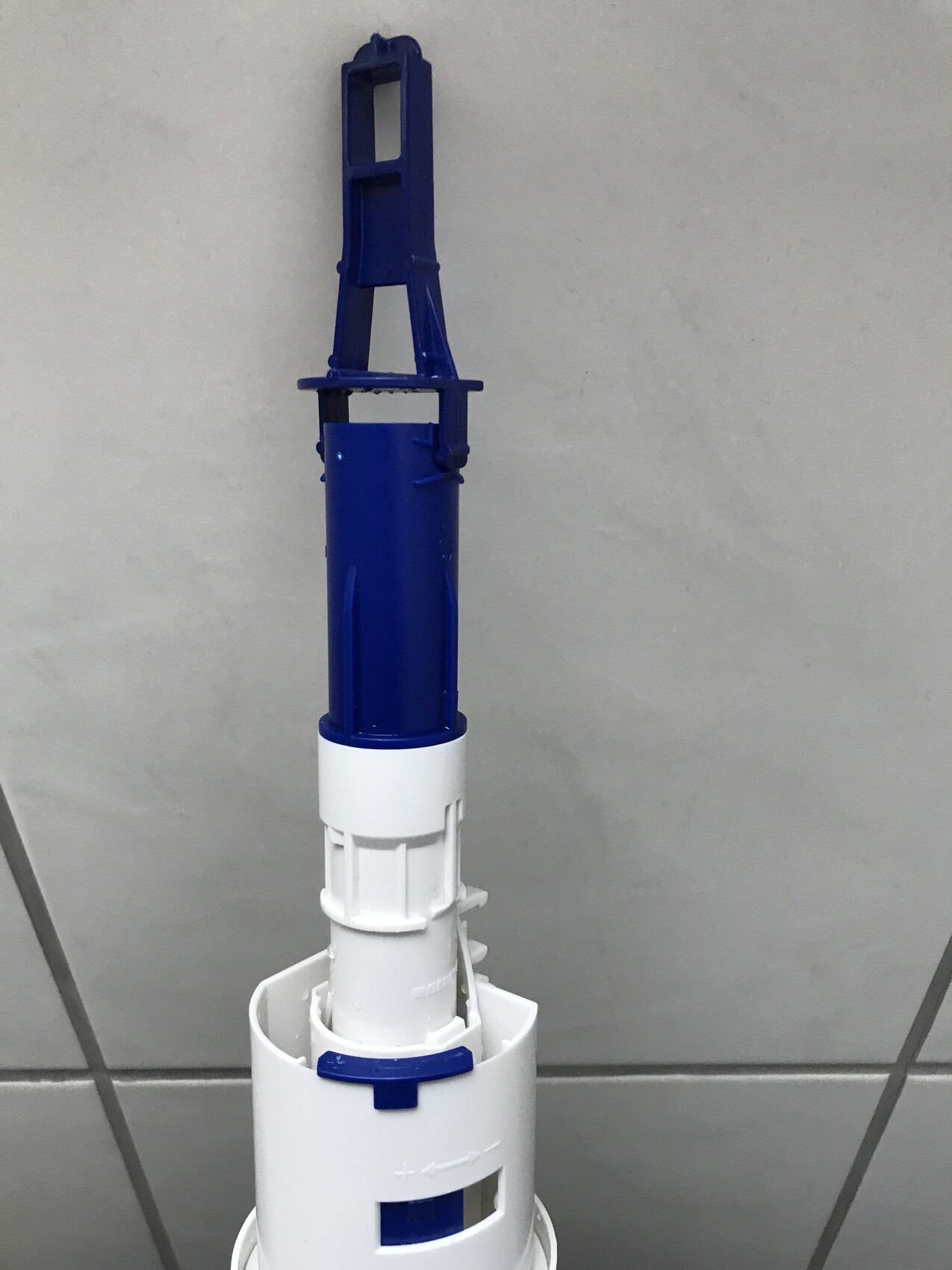

Mycraft schrieb:
the lever might simply be too longThat was exactly the problem for our weak flow... the plumber just shortened it by breaking off the too-long rods.
J
JoeWet47117 Nov 2020 12:55Steffi33 schrieb:
That was exactly the problem for the drip in our case... the plumber just shortened the too-long rods by breaking them off.Could someone please explain what might be too long and especially where I can screw or shorten something?
I don’t want to damage the new one faster than it was ordered. 😉

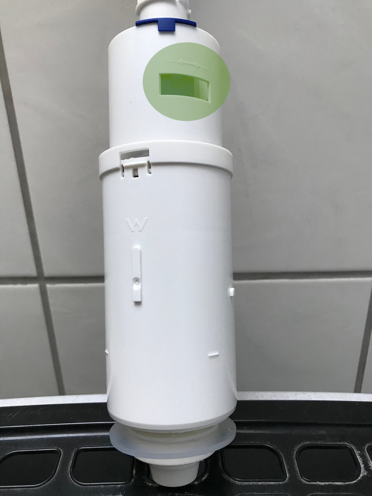

And does anyone have an idea what this +/- might mean?
In the picture, a slider is marked green. I just have no idea what happens with that.
I took everything apart again. I replaced the gasket with a different new one. At the bottom of the housing, where the gasket sits in my opinion, I tried to clean it a little with a cloth.
Then it worked well 4–5 times. But then the drip returned, not as strong, but it was still there. 🙁

JoeWet47117 Nov 2020 15:30Oh, those were the ones you meant.
That actually makes sense.
I screwed them in a bit further. Possibly the front cover plate was applying some pressure, causing a slight movement.
In my test, it always worked when the plate wasn’t on yet, and then water flowed again once it was in place.
At the moment, it looks good.
Many thanks. Maybe that was the issue. 😎
