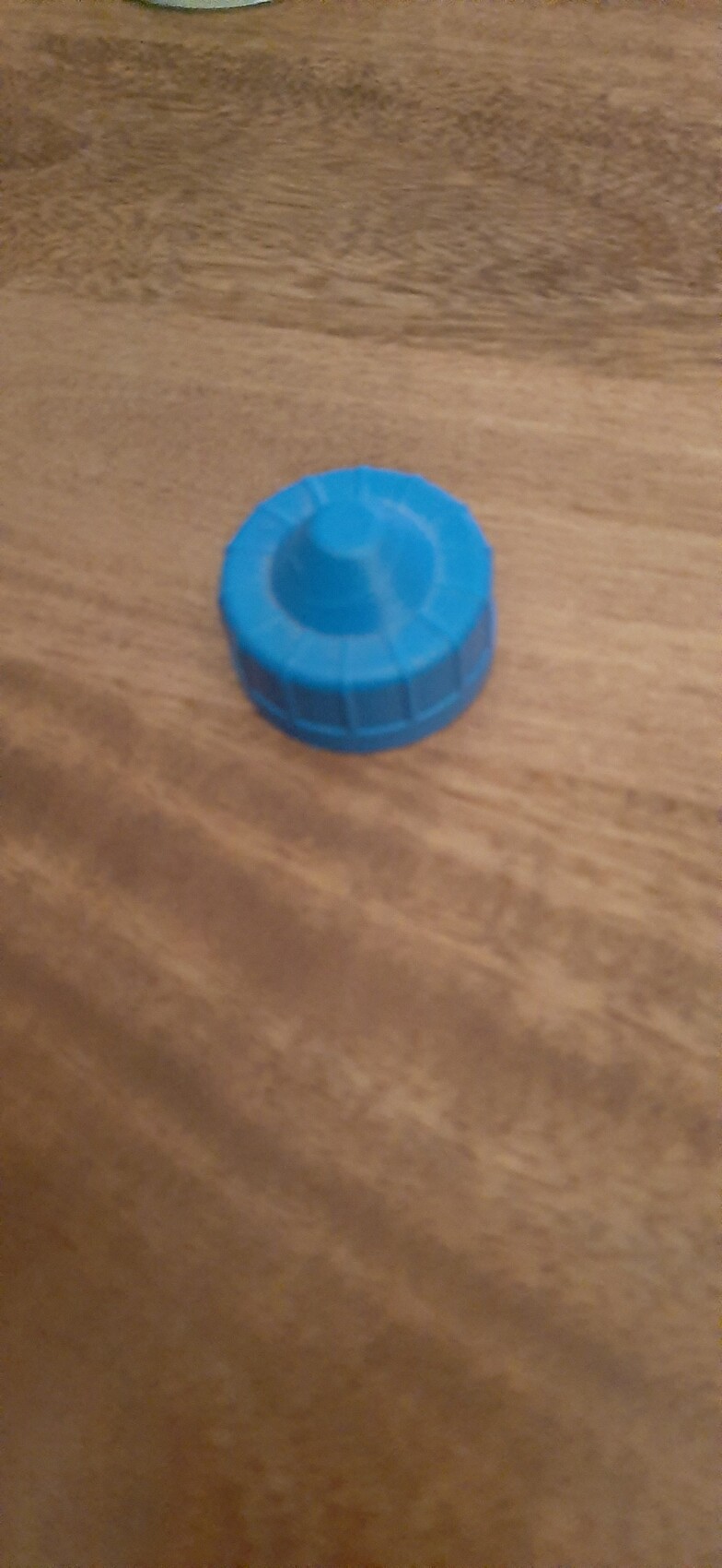

The actuators would have pushed the pins down, the ones sticking out on top, I assume? I still have protective caps. If I screw them on, the pins will eventually go down. I just pressed three individual pins once. The corresponding float then briefly drops to zero.
Blue plastic cover with inner cylinder, lying on a wooden surface.
K1300S6 Dec 2020 16:48
That's right. This way, you can permanently close the heating circuits.
K1300S6 Dec 2020 16:59
The actuators can only be fully open or fully closed – not "partially open" or "almost closed." That’s why you essentially have a stop on the valve, which can be adjusted via the square section made of copper.
