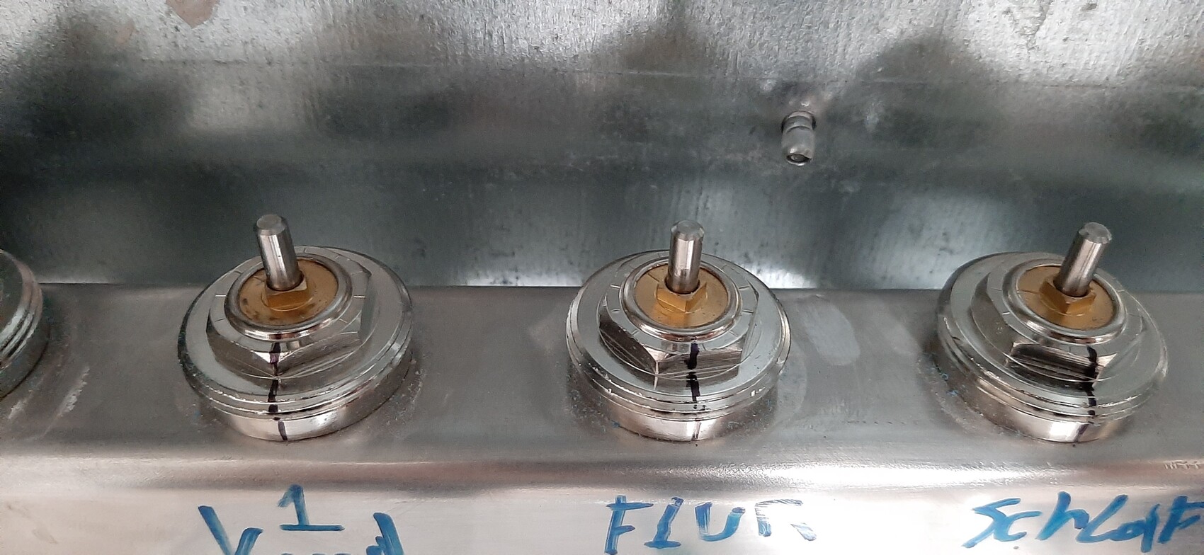

Sorry to ask again. I already removed the actuators some time ago. I’ve attached another picture. I was about to loosen or turn the hexagon to the left to adjust it, but it’s quite tight. I didn’t use a lot of force, but is it really correct to turn the hexagon, or should the copper part be moved instead? In my opinion, the hexagon is stuck. So it seems it’s not meant to be adjusted.
Drei Ventilbasen mit Stangen auf einer Metalloberfläche
opalau4 Dec 2020 17:38
I think you need a square timber here.
Mycraft4 Dec 2020 17:42
Yes, only the brass part. In your case, it is a square shape. The large part is the entire valve, which you should not touch, otherwise water will come out.
seat884 Dec 2020 18:07
It is clearly visible that the hexagon and the exposed valve underneath form a single unit. Of course, you only need to turn the square drive...
