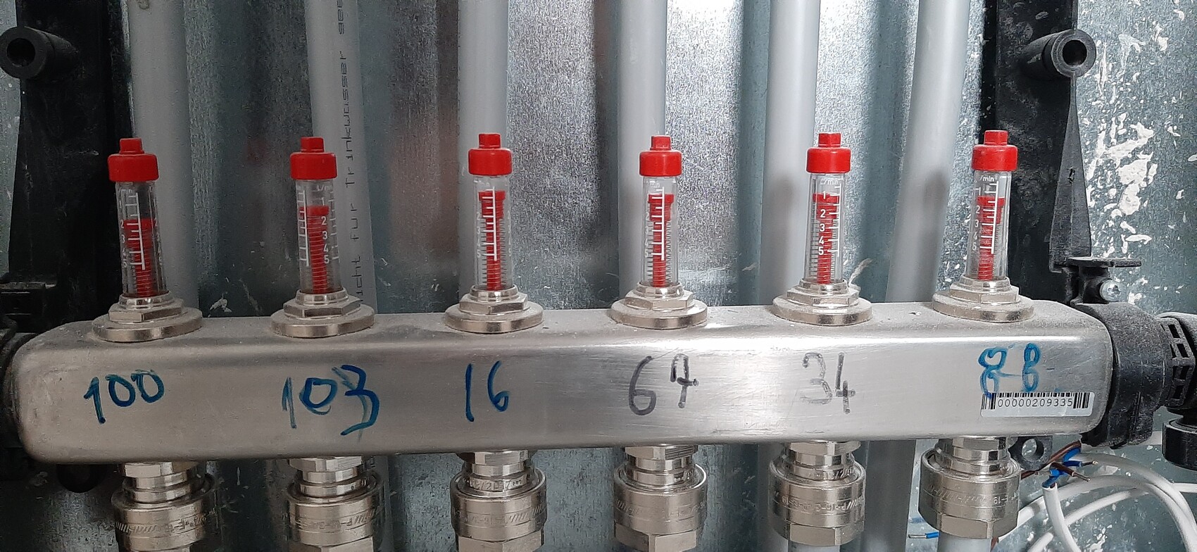

I just looked inside my distribution box. To my surprise, the adjustment options are quite limited. I’ve attached a picture and listed the values from the image from left to right.
Bathroom 1.9
Child’s Room 1 1.25
Hallway 0.5
Bedroom 0.75
Dressing Room 1
Child’s Room 2 1.4
The bedroom and the dressing room are essentially one space with an open connection. I will reduce the dressing room flow to 0.75 to test it out.
The flow rate to the bathroom is very high. It also feels noticeably warmer there, though I can’t measure that. Strange, since the flow rate is twice as high.
Where do I adjust the flow? At the top near the red caps? I saw in a video that water came out there on one system, but it was a different setup.
