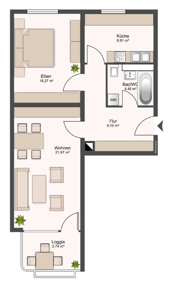

This time it’s not about a house, but a 62 sqm (667 sqft) two-room apartment consisting of a living room, bedroom, kitchen, bathroom, and hallway. A floor plan is attached.

Regarding the floor plan, I would consider using one or two types of tiles—one for the kitchen and hallway, and another for the bathroom. Then, use a "warmer" flooring material for the living and bedrooms. Of course, you could use the same flooring throughout, but if you plan to rent out the property, I would recommend tiles for areas that tend to get wet or dirty. In this case, that would be the kitchen, bathroom, and hallway, which can be nicely grouped together—especially the hallway and kitchen. Since the bathroom is separate, you could choose a different type of tile there.
