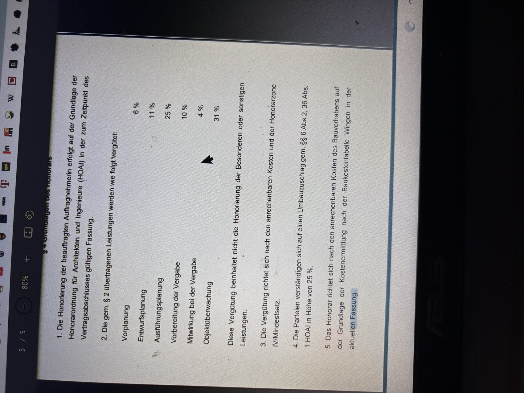

Antjeaergert12 Feb 2025 23:4511ant schrieb:
Which 25% due to heritage status and additional effort? That is exactly what the HOAI table’s difficulty levels are for!A renovation surcharge of 25 percent is applied according to §6 paragraph 2, 35 part 1 HOAI, amounting to 25.
