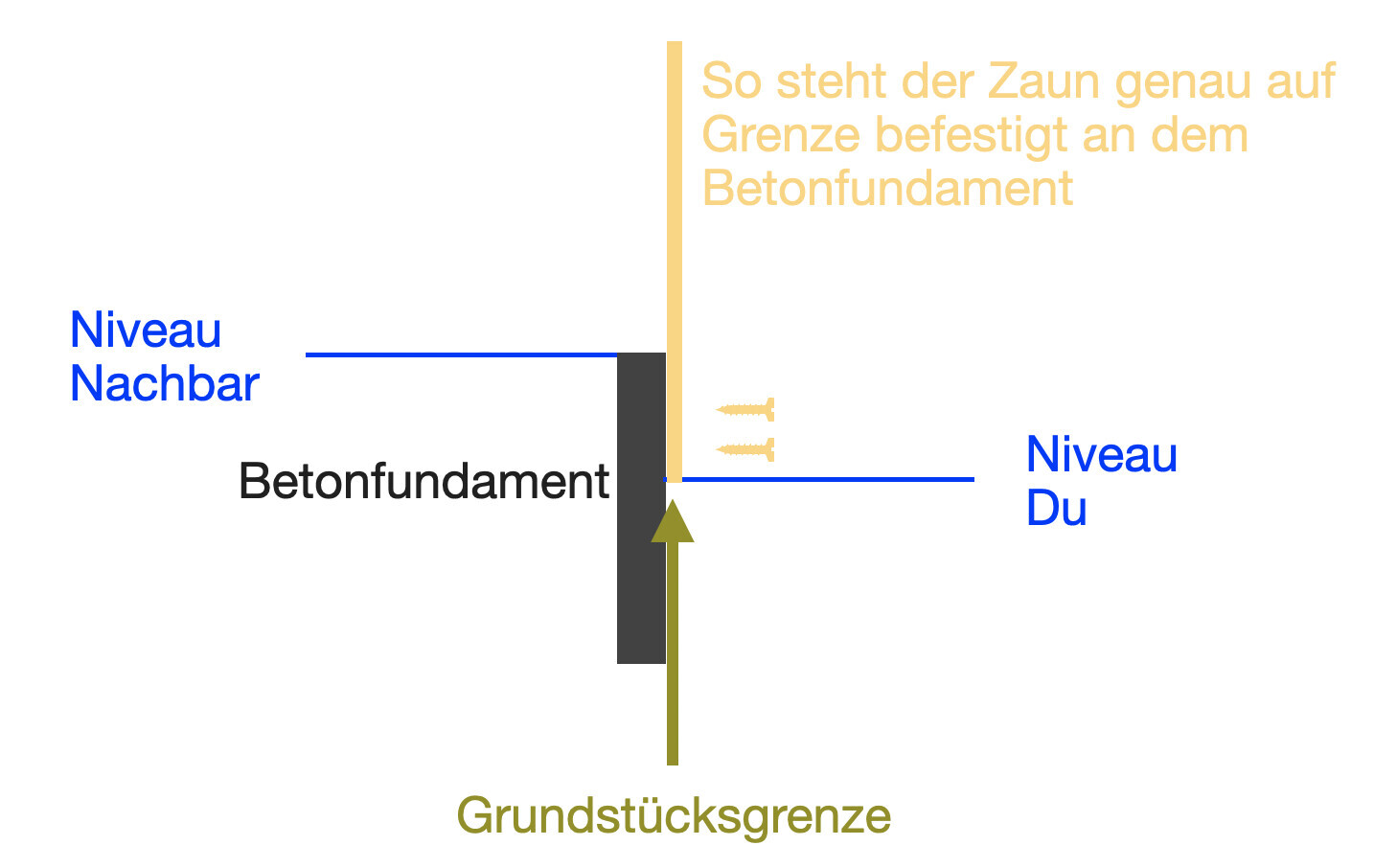

hampshire23 May 2020 09:53Set concrete blocks between the terraces to support the step, then place the terrace covering on top. This way, you would have some concrete.
Alternatively, you can attach the covering sideways to the concrete divider, so it won’t be visible. If you all agree well on the location of the concrete divider, it can also be aligned correctly with the property boundaries.
I don’t know how particular you are about that.
Corini198523 May 2020 12:11I find it hard to visualize everything. The height difference is 30cm (12 inches). Would the fence then need to be screwed onto the terraces instead of being set in concrete?
