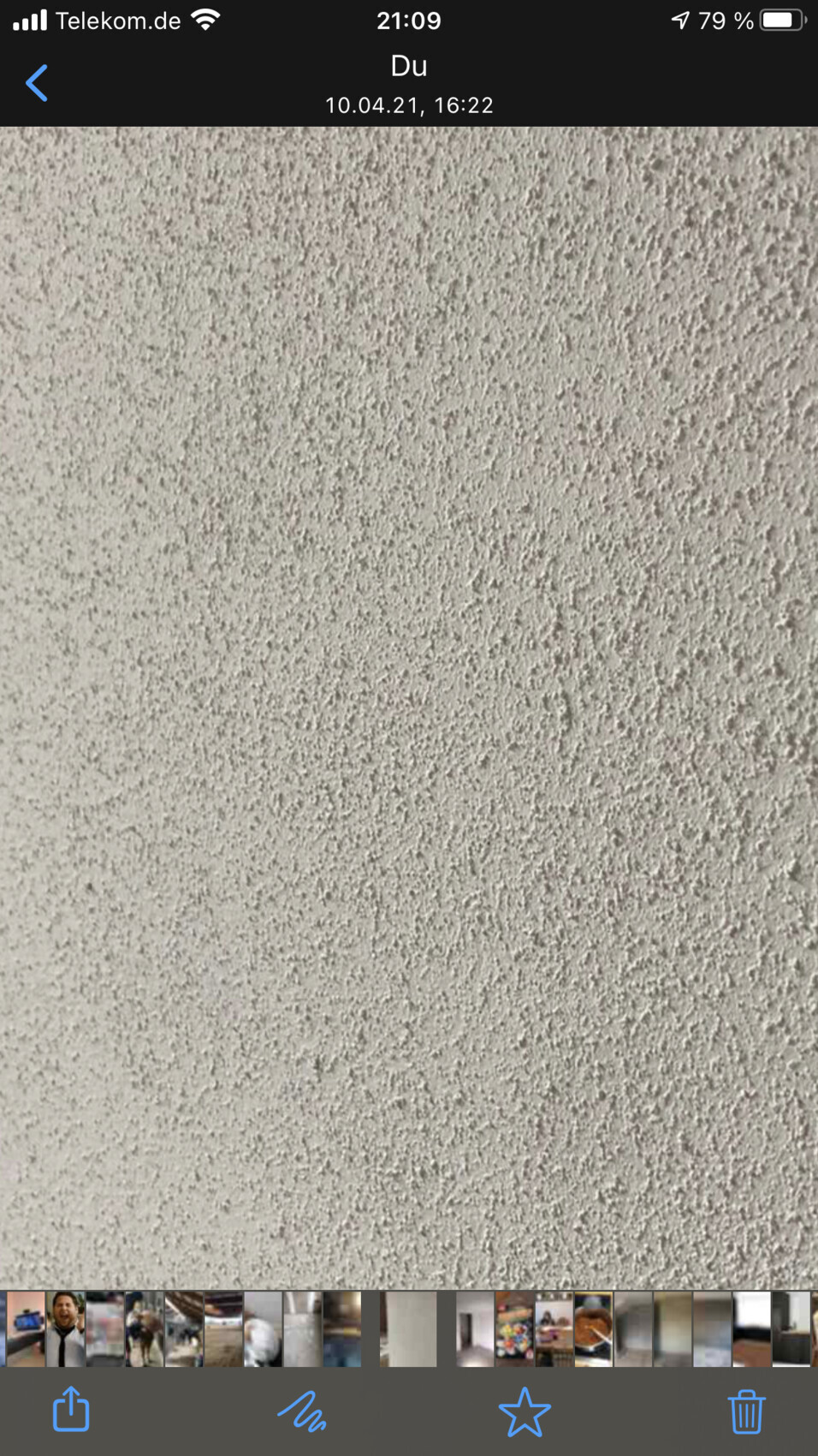

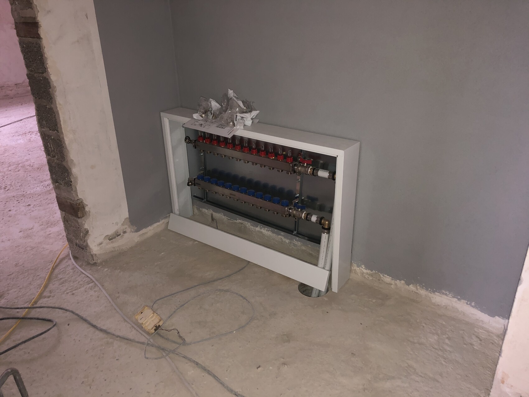

nordanney20 Apr 2021 21:10dpauso7766 schrieb:
What type of substrate did you have and how did you treat it?Old gypsum plaster: no treatment (there was wallpaper on it) Old cement plaster: no treatment
New drywall: primer
Noticed difference: none with any of the methods
The gray photo shows cement plaster, the white one unfinished gypsum plaster.
