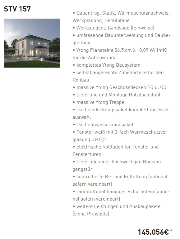

sarajevo839 Feb 2026 15:0611ant schrieb:
Oh, no, “system wall elements” probably refer more to Xella prefabricated houses (?) No, I just came across this by chance:
There even with a 36cm (14 inch) wall as a SWE
By the way, I still don’t like spreading the same project across multiple small threads. Sorry! I thought it would be clearer for all future home builders that way...
sarajevo83 schrieb:
No, I happened to come across this:
There, even with 36cm (14 inches) walls as aerated concrete blocks Not as "system wall elements," but as plan blocks for self-building. For a price of 145k, this practically means that a total of 326k (471k minus 145k), including the "margin" for your own work, is budgeted to turn the house into a move-in ready home with the help of finishing contractors.
Only the gods know why Xella doesn’t offer the same models as Xella yellow (Ytong) and Xella orange (Hebel), but rather in the quite different versions "STV 157" (Ytong) and "Single-family home city villa 149" (Hebel). Both are kit houses, whereby the Hebel houses are assembled from full-story vertical elements (which requires a crane), while the Ytong houses are built classic brick-by-brick (using the same type of plan blocks from the pallet that you can also buy “individually” at building supply stores, meaning by the pallet but not included in a complete kit with the other parts). In this building materials sales channel, the blocks differ only by the color of the packaging around the pallets. Many value-added resellers (main contractors) also offer the blocks of both brands at various processing levels (up to a move-in ready house). While the kits for both Xella aerated concrete brands also provide for ceilings and even pitched roofs made of aerated concrete, general contractors who work with these plan blocks typically prefer traditional reinforced concrete ceilings and timber roof trusses. I can gladly refer you to someone, but I recommend personal consultation. As I said, we can also meet in MüKä.
