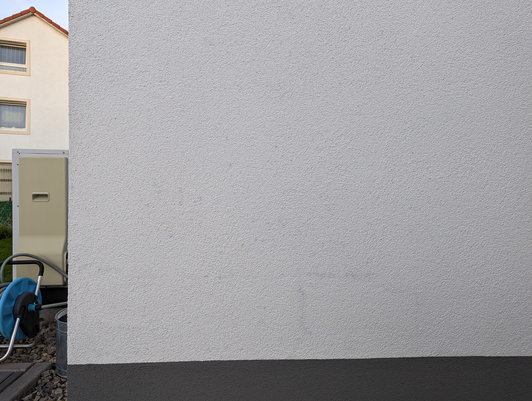

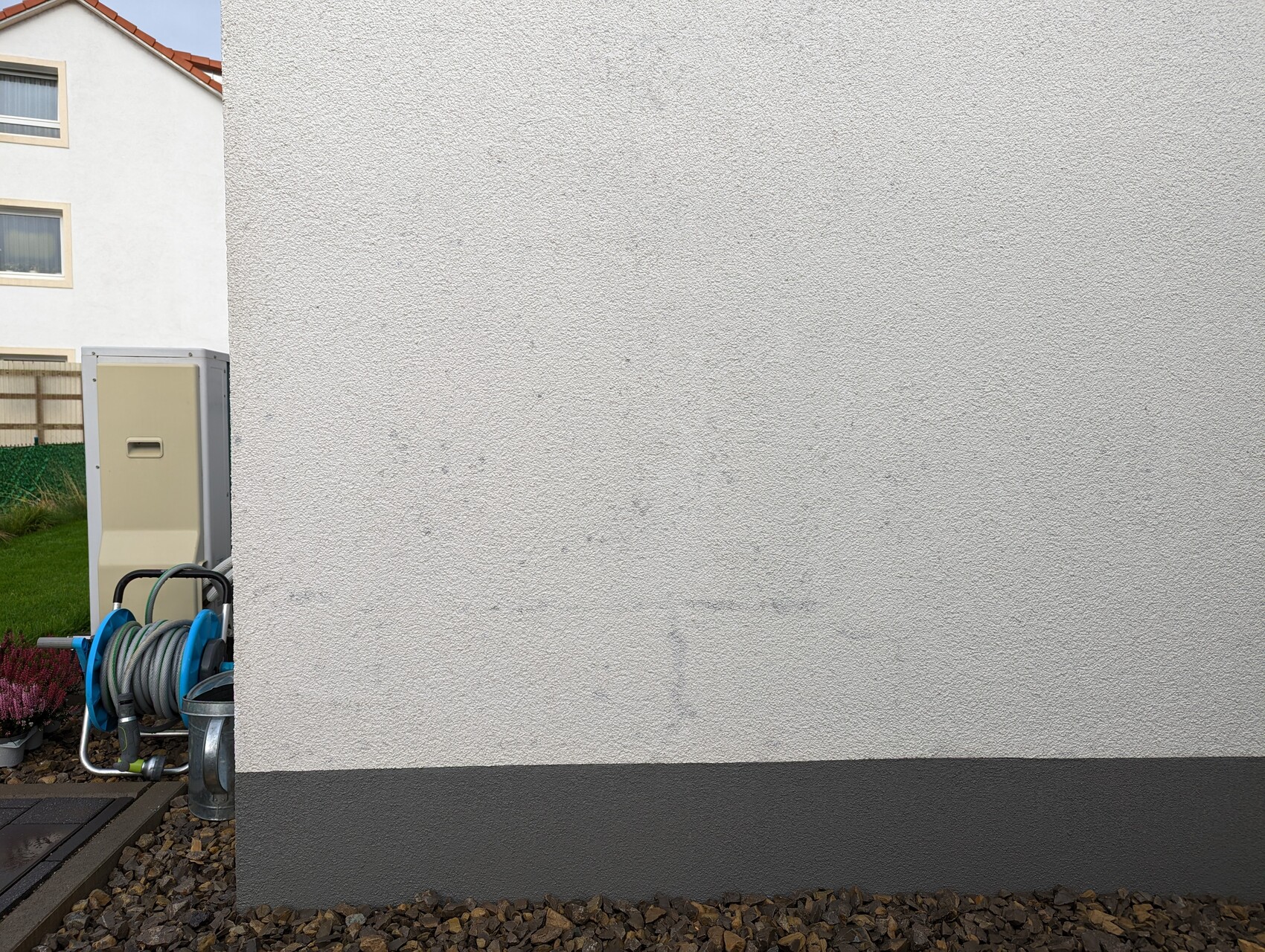

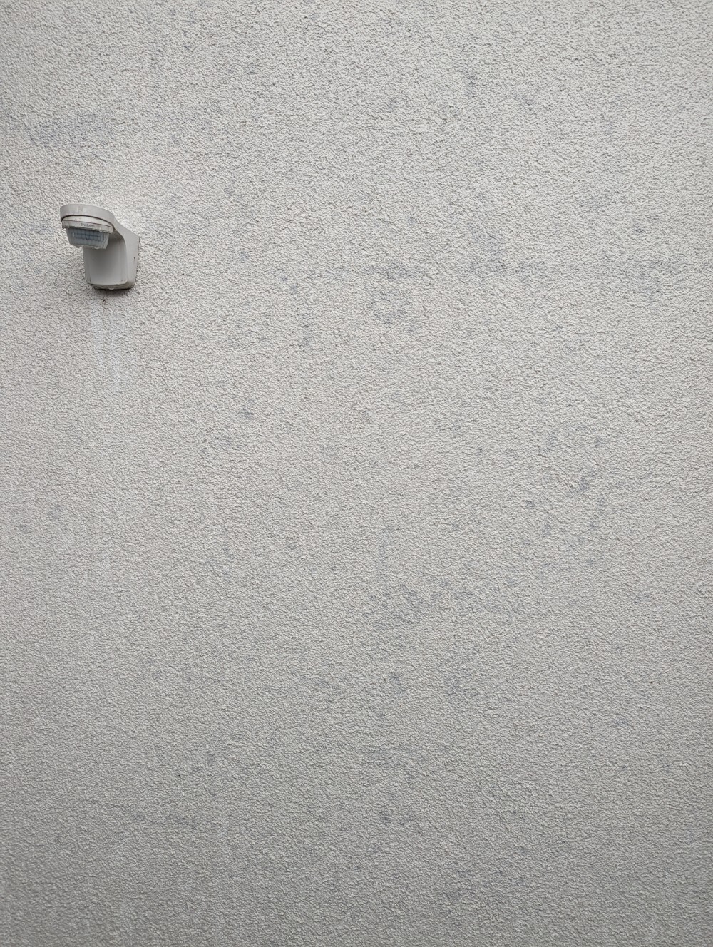

Our house was built in 2020 with Poroton blocks (42.5cm (17 inches), no external insulation system) and plastered. I don’t have more specific information about the plaster.
On the west side, we can see stains on the damp exterior wall, and the joints are also slightly visible. On the dry wall, the stains are hardly noticeable. Other exterior walls, either on our house or at neighbors’, show no abnormalities.
I understand that plaster can develop mold over time. However, I am surprised why the stains are only so noticeable when the wall is wet. Could the plaster be too thin, causing the masonry to “show through”?
I have an appointment with the builder soon, so I would appreciate your neutral opinions. Thank you!

ateliersiegel16 Oct 2022 10:17
The cause – at least from my perspective – is that it was done "as cheaply as possible." Understandable and initially just a little "unwise."
One important detail I consider is:
Does it have technical consequences that worsen over time?
As long as the issues are only cosmetic, you can live with it.
If there are effects on the structure, something should be done.
