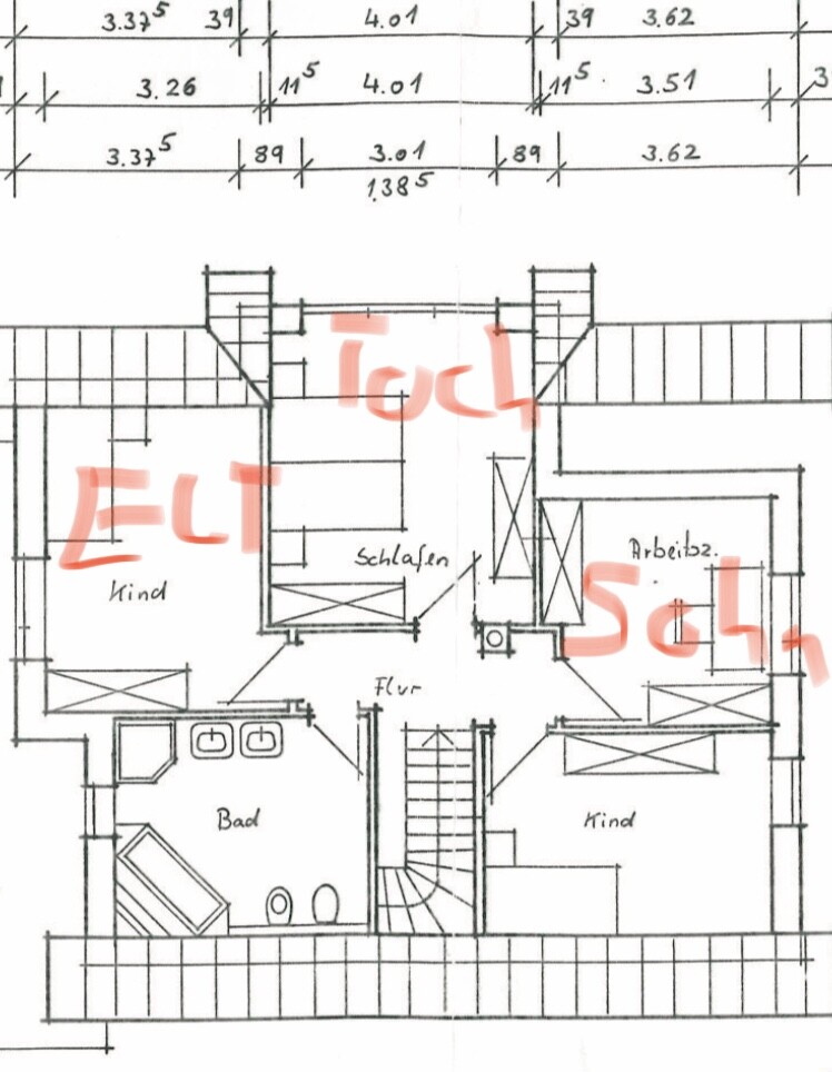

Here is a photo of the floor plan. This helps to better visualize the layout.
The ceiling structure is traditional:
Drywall, insulation, drywall, OSB panels (construction viewed from the room looking towards the attic)

I think it’s important to first analyze whether it only concerns the two rooms or the entire house/upper floor. An electrical outlet is a common cause; if you plug something in on the ground floor, you can hear it very loudly upstairs. Reason: hollow bricks! This initially surprised me as well, but it actually makes sense. You get somewhat used to it since it doesn’t happen very often 🙂
Otherwise, do you hear many noises through the roof from outside or only between rooms?

Nida35a1 Feb 2021 10:52
Are the interior walls drywall or solid? Try knocking on them.
Wintersonne
1 Feb 2021 12:59
Are all interior walls only 11.5 cm (4.5 inches) thick? Minus the channels in some places?
We were told that the walls should be at least 17.5 cm (7 inches) thick, and then it also depends on the bulk density.

Solid, but probably only 11cm (4.3 inches) thick blocks, and most likely aerated concrete.
