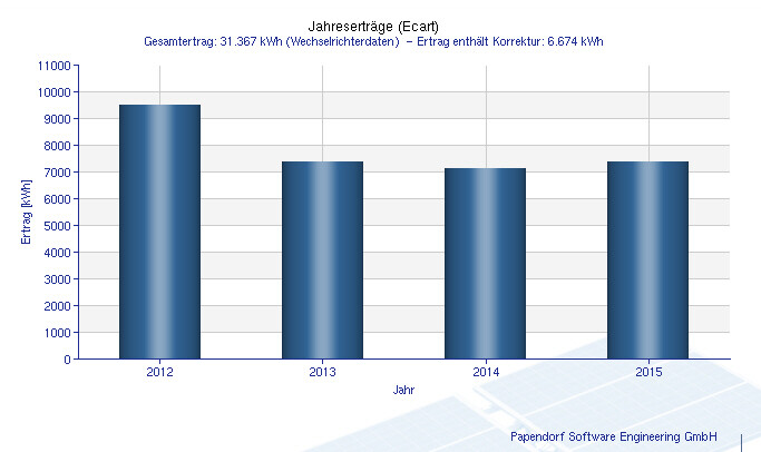

Solar PV is very cost-effective for us (connected to the grid at the beginning of 2014). It pays off after just over 10 years with full financing. Could you please share some data (screenshot) from your solar PV system?
For me, it’s also around 10 years; the solar PV system has been operating since 07/2011.
Solar PV system (8.225 kWp).
Feed-in tariff: € 0.2874
Self-consumption: € 0.1236
Value 2012: (Period = 07/2011 to 2012)
Value 2015: As of today (19.10.2015)
