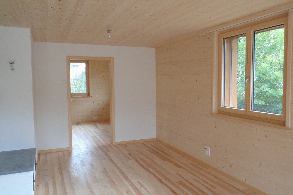

Here you can see an example of the timber wall. There are now several systems that can implement solid timber walls very well without glue or plastic.
During construction planning, the electrical system is considered and the channels are pre-milled. Everything is fine. Wall heating is installed on the interior walls (timber studs). It works as well.
And we do want to improve. That is why we asked for opinions here. I really appreciate your open exchange.
