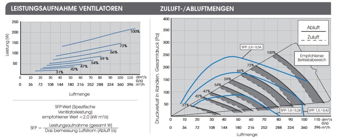

Where can I see the set airflow rate in m3/h (cubic meters per hour) on the system?
I have the Vallox MV 350, and as far as I can tell, only the fan power can be adjusted in percentage, separately for supply and exhaust air. I will take a picture of the interface menu when I get the chance.
