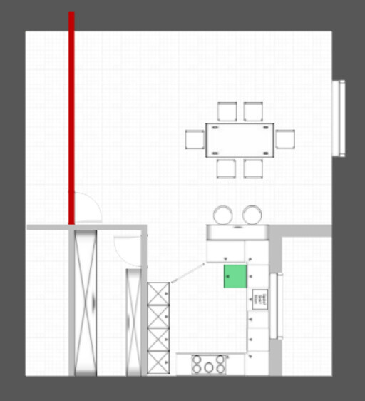

Floor plan of a dining and kitchen area: dining table with chairs at the top, kitchen at the bottom right.
The dishwasher door is marked in green, the line from corner to corner shows a 100cm (39 inch) clearance, the table measures 90 x 180cm (35 x 71 inches). I have no idea how large it should be.
The red line indicates the maximum room depth.
