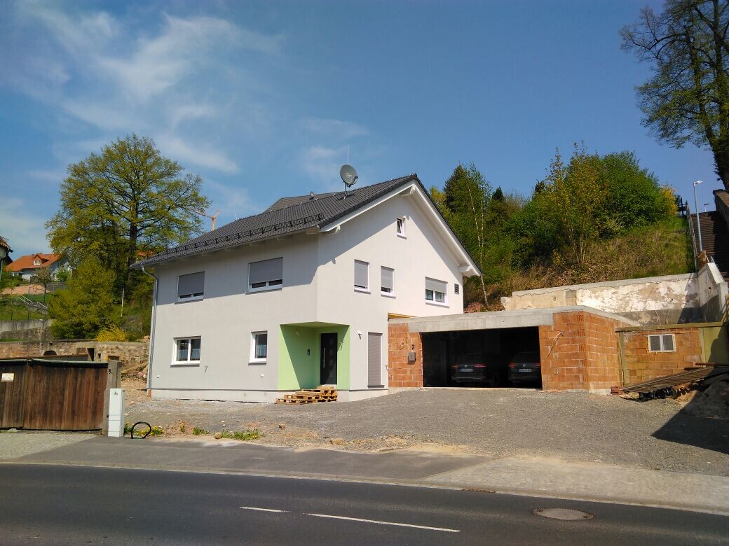

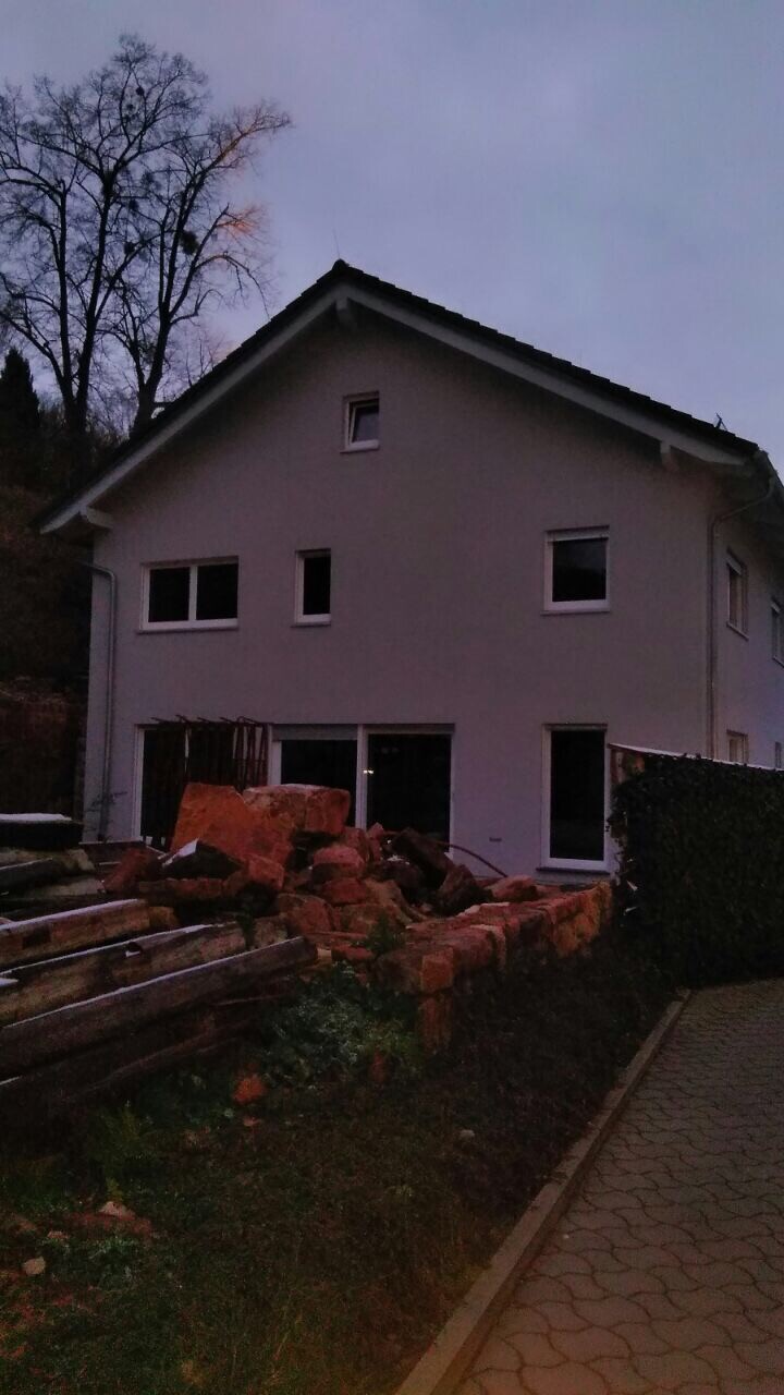

Our house closely resembles an urban villa. Just imagine a different roof.
The house needs to match the plot. Otherwise, it will become expensive.

11ant1 Jun 2018 14:44
haydee schrieb:
Our house looks quite similar to an urban villa. Just imagine a different roof.
Ah, I see. It looks nice, I wouldn’t have guessed that just from the drawings alone. I’m curious to see how the final entrance stairs will turn out. Have you covered the remaining wall parts in the background with zinc sheets?
haydee
1 Jun 2018 15:08
Not yet. The roofer stood us up in October. Now we have finally found someone who will do the work. Plastering is scheduled for June, and the flat roof will be installed as well.
The sandstone wall will be repointed and given a neat finish once the mason is healthy again.
