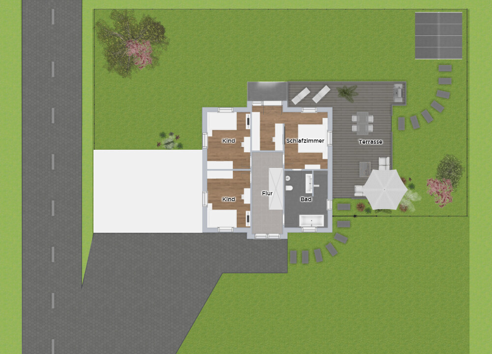

It’s around 3000 m² (0.74 acres), but about 70% is steep hillside.
Only a small part of the land is shown in the pictures—it extends much further to the right, but as I said, it’s all steep hillside and therefore not very usable. Maybe we’ll put some goats up there!
The slope is our biggest problem. We definitely don’t want to build another house on a hillside.
We plan to level a large area completely (marked in dark green), and we’re already dreading the work and the associated costs.
Our advantage is that we have many helpers and my father-in-law can provide an excavator and other equipment. However, disposal will be expensive (we’ll reuse some of the soil to fill in the slope next to the driveway). Does anyone have experience with this? Is it really as straightforward as it sounds?

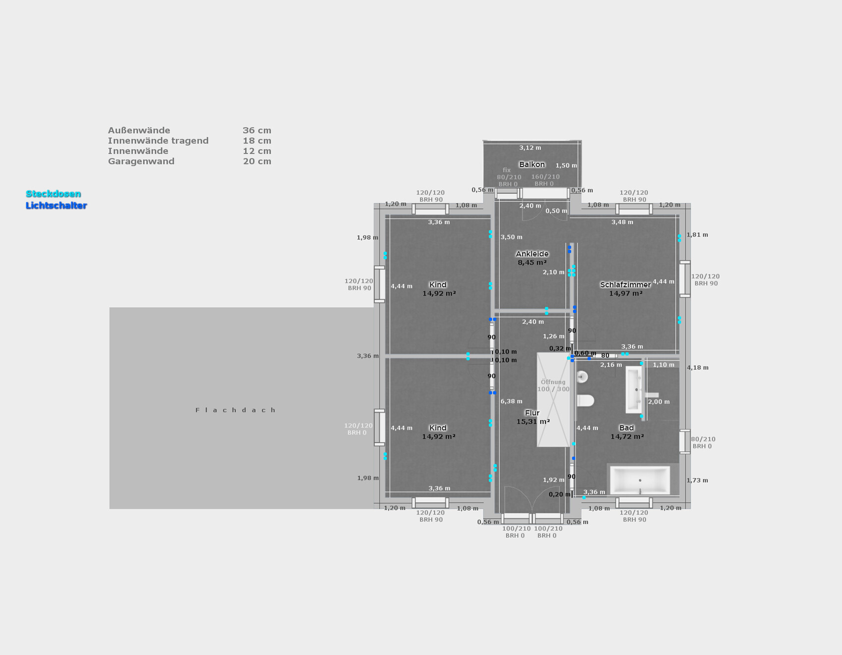

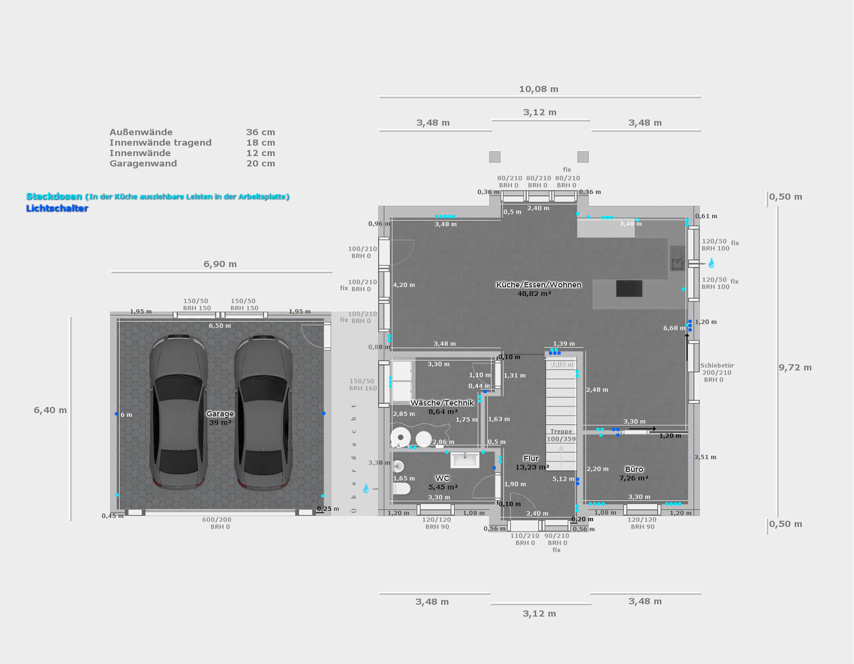

The floor plan shows a town villa with about 166 m² (1786 sq ft). We haven’t decided yet whether to go with prefab or solid construction—I’d prefer solid construction, but my partner is convinced by prefab. We’ll see. Does that make a big difference in price?
Since, as mentioned, we don’t yet know the zoning plan, we could also build a regular single-family house with sloped ceilings if that’s all that’s allowed. But then the bathroom door on the upper floor would be tricky.
(Does such a small village even have plans you have to follow, like in a new development area?)
Now to the main question, aside from all the problems with the slope, etc.: What do you think of the floor plan? I designed it myself—I’ve been working with the program for months, considering different options, planning and replanning. I’ve probably made 10 other versions before arriving at this one—and I think it’s perfect now. Surely there are similar floor plans out there; it’s nothing extraordinary.
Do you have any suggestions for improvement? Have I included any major mistakes that I don’t see? Anything that’s technically not possible?

I would like to point out that having two entrances to the bathroom is impractical (constantly locked because the previous user left through the other door and did not unlock it again) and that the bedroom in this layout functions as a central passage room. You look forward to having the walk-in closet and letting the person sleeping longer rest, but then you have to walk back and forth (and back again because you forgot something) or even go to the bathroom and back in between…
And: a balcony accessible from the walk-in closet? I’m not sure. There is no direct objection since in a detached house with a garden it is usually (almost) never used anyway, but it still seems a bit odd.
On the other hand, I find the kitchen corner between the living and dining areas very well designed, provided it is furnished appropriately for its central location and role. The stove has “always” been the central element of a house, and here the kitchen divides the open-plan space in a natural way. That’s exactly how I would like it, but unfortunately our other, more mandatory framework conditions don’t allow it.
I would probably look for a different kitchen location as well. Are you building without a basement? If the staircase can be enclosed and isn’t absolutely needed as a coat area, you might consider:
- Making the office accessible from the hallway and closing the door toward the living area
- Placing the kitchen on the wall next to the office
- Possibly even enlarging the office wall a bit
- Creating a small pantry under the stairs accessible from the kitchen side
Accessing the walk-in closet through the bedroom is often criticized here in this forum. In the layout shown here, what bothers me even more about the bedroom is that the bed is placed under a window. You won’t have easy access to open or clean it (sure, you can get into bed, but cleaning without spilling drops or water on the unstable surface would be difficult). Additionally, many say this setup feels unsettled, as people might prefer a solid wall behind their head when sleeping.
By the way, in my opinion, you have very little storage space without a basement. You should seriously consider whether that will work for you. But overall, the house is quite livable and, to me, doesn’t have any major flaws.
Oh, and where possible, always position doors with some distance from the wall so that cabinets can be placed behind them.
Edit: I overlapped with Kekse and overlooked the door between the bedroom and bathroom. We also have direct access to the bathroom, but there is a second bathroom for the kids. With only one bathroom, I would never install this door or spend money on a soundproof door. You can hear much more than you would through a solid wall, and especially when kids come home late from parties, the peace for everyone would be over.
First of all, thanks for the replies.
It’s true that I designed the floor plan myself and did not use any – as you so kindly put it – “Horst von Hümpel” template. As mentioned before, it’s possible that a similar floor plan already exists and it’s not entirely original. And that was exactly my intention. I don’t want a complicated, cramped layout. Clear lines and a straightforward arrangement.
In my opinion, identical children’s bedrooms have only advantages. It prevents arguments between them, doesn’t it?

That’s only half the truth, as you must have already absorbed a lot of "inspiration". Just asking a bit sharply: which Horst von Hümpel house type was the basis for this?
Symmetry is not a value in itself – in fact, it can be a hindrance to originality – and equal-sized children’s bedrooms, in my opinion, only suit twins.
I hadn’t noticed those yet – but what are the blue dots?
I have explained in the floor plan what those dots mean.
And yet you already drive a Zafira?
Would it be so bad to already drive a Zafira? But no, I don’t.

Why don’t you want a house on a slope? What’s wrong with that?
Thanks for the kind reply. We would carry out the demolition and leveling of the plot ourselves, and possibly the garage as well, depending on the offer.
We currently live in a house on a slope, and to me, it doesn’t look very appealing (seems bulky), and the distances seem longer that way. Or am I mistaken?
