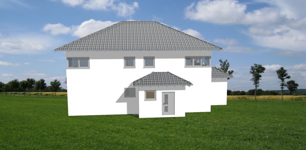

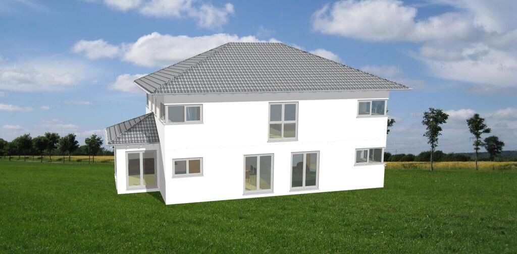

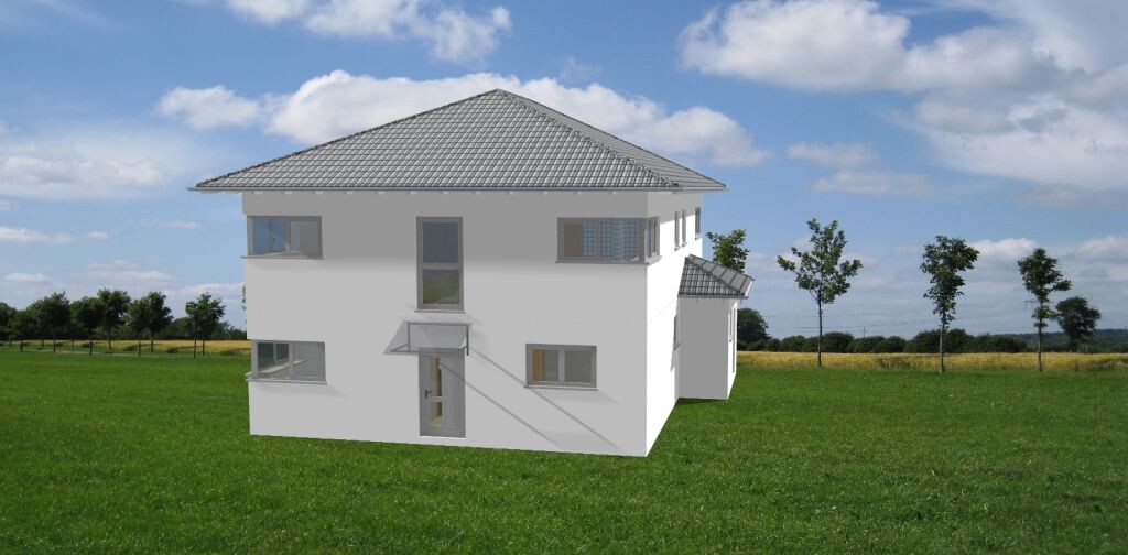

After completely redesigning our first draft https://www.hausbau-forum.de/threads/planung-steht-fast-eure-meinung-erwuenscht.10701/, this is the result 🙂
What do you think of the second draft!? I personally find it much better than the first one!?
Our requirements/wishes remain the same:
- Single-family house with a separate apartment (for the parents and later for renting out). Main living area approx. 160 sqm (1,722 sq ft), separate apartment 50 sqm (538 sq ft)
- No basement, but storage space under the stairs on the ground floor, in the attic, a larger garage, and a garden shed
- The development plan allows for 2 full floors (roof pitch up to 28 degrees), so it will have a hipped roof
- Solid construction with 36 cm (14 inches) T9 bricks
- KfW 70 energy standard
- Heating: gas condensing boiler
- Underfloor heating
- House orientation: unfortunately not marked on the floor plan, but top is north, bottom is south
- We definitely want a walk-in closet and a master bathroom in the bedroom
A fireplace is still to be planned... the question is, where would be the best (strategic) location!?
I’m considering whether to install 3 decentralized ventilation units (1 in the separate apartment, 1 on the ground floor near the kitchen, 1 in the master bathroom). Do you think that makes sense or not? (Please briefly comment... I don’t want to start a discussion about this 🙂 )
Especially since I heard that according to the new Energy Saving Ordinance 2014, it is advisable to plan a central ventilation system (I’m not a fan of that and don’t want it!)
Thanks in advance for lots of feedback
