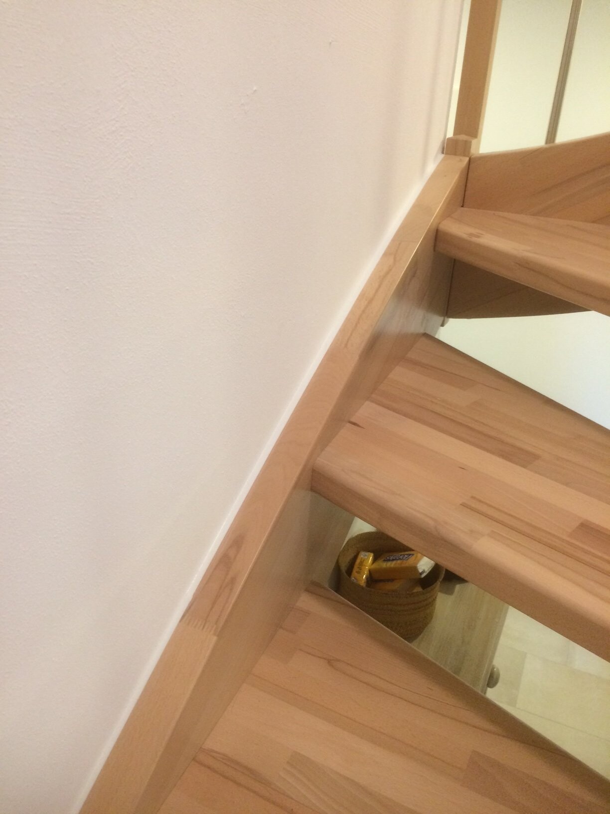

It should be sealed with MS polymer. Completely waterproof and airtight, curing underwater, commonly used for hull penetrations on ships to seal them (such as echo sounders, vent outlets, etc.).
Practically no shrinkage. Practically never fully hardening, especially not on the inside, extremely adhesive without the need for a primer.
Here is a joint between a wall and a staircase that we sealed to close the gap. Saba Tack white was used.
Light wooden staircase with open steps; below a basket with snack bars.
