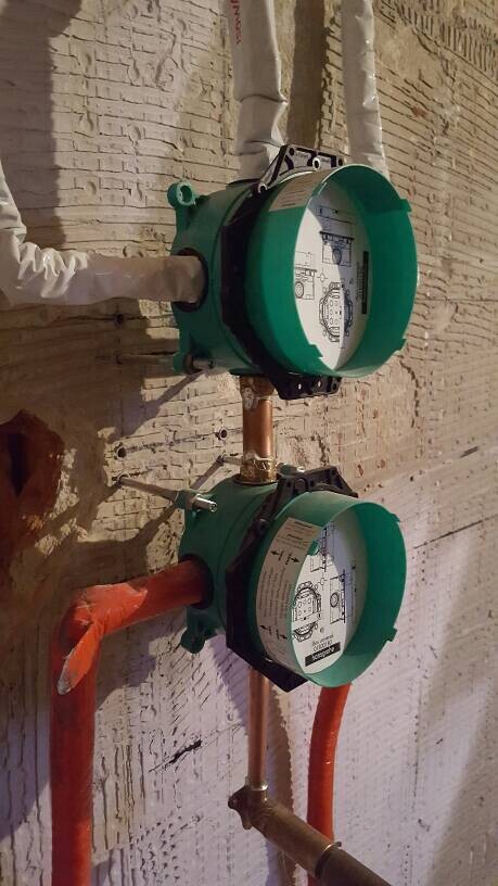

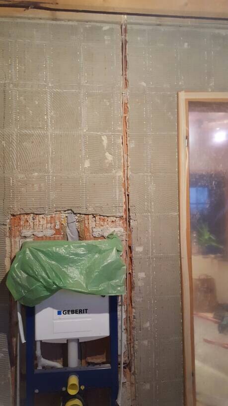

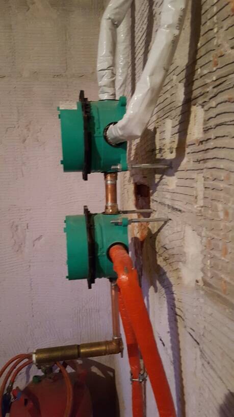

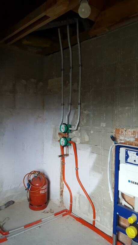

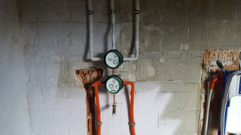

miniflexalex20 Apr 2017 22:26Completely forgot, today the first updates of the fittings (Grohe iBox) were installed. The wall is still being built up with Ytong blocks, so the fittings were simply screwed onto the old plaster for now. I’m attaching a few photos because I’m not very happy with the workmanship, but maybe I’m being a bit too picky? For example, each iBox is fastened with only two screws instead of four, and the pipe routing looks somewhat careless to me. Do you usually insulate the hot water pipes that run along the concrete and will later be encased in screed? What do you think of the installation? Thanks in advance.
