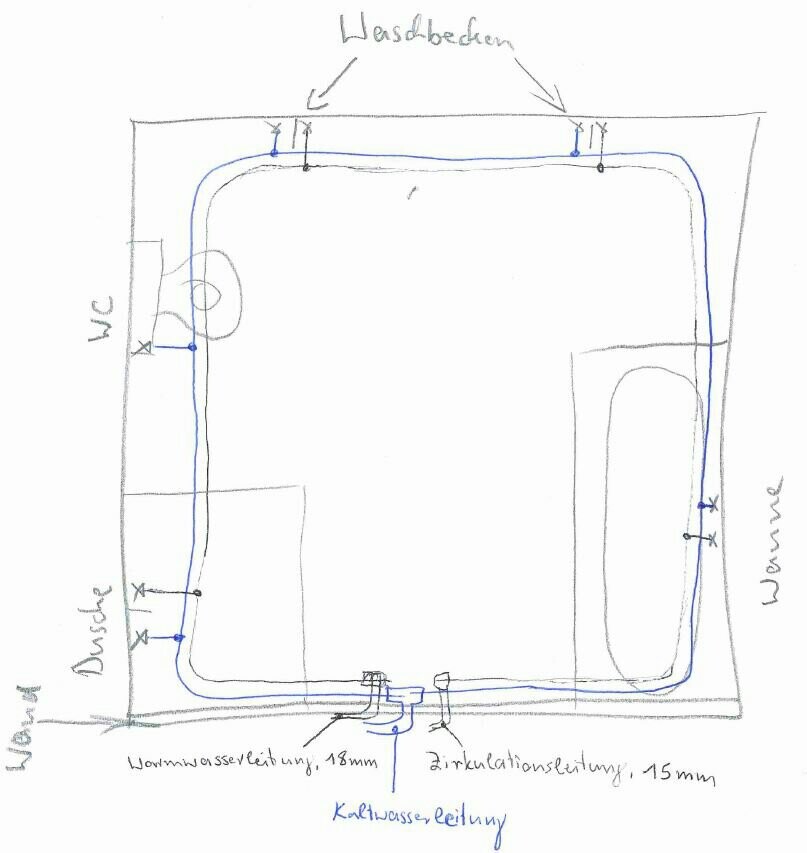

Hello everyone, my plumber wants to install a ring circuit for cold and hot water in my bathroom (see sketch).
He plans to extend the 18mm (3/4 inch) hot water supply line through the bathroom and then connect it at the end of the loop to the 15mm (1/2 inch) hot water circulation line... Is this really the correct method?
Thanks
Thanks

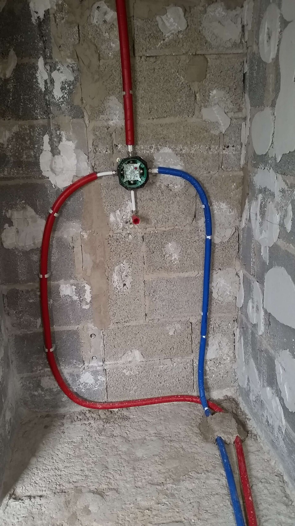

Here’s how it looks at my place:

This is how it looks in my place:
Hello and thanks for the reply. Actually, it doesn’t matter whether the pipes are neatly installed since plaster will cover them, but it still annoys me because it was just carelessly slapped onto the wall. Yours looks similar.
