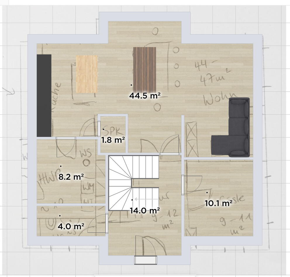

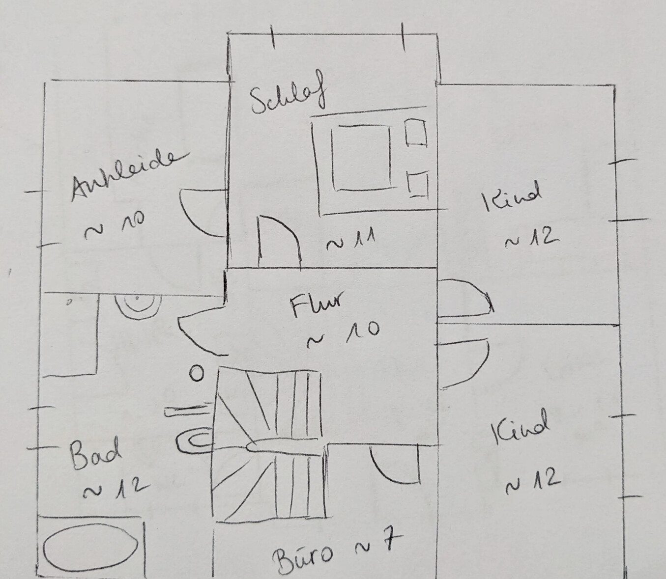

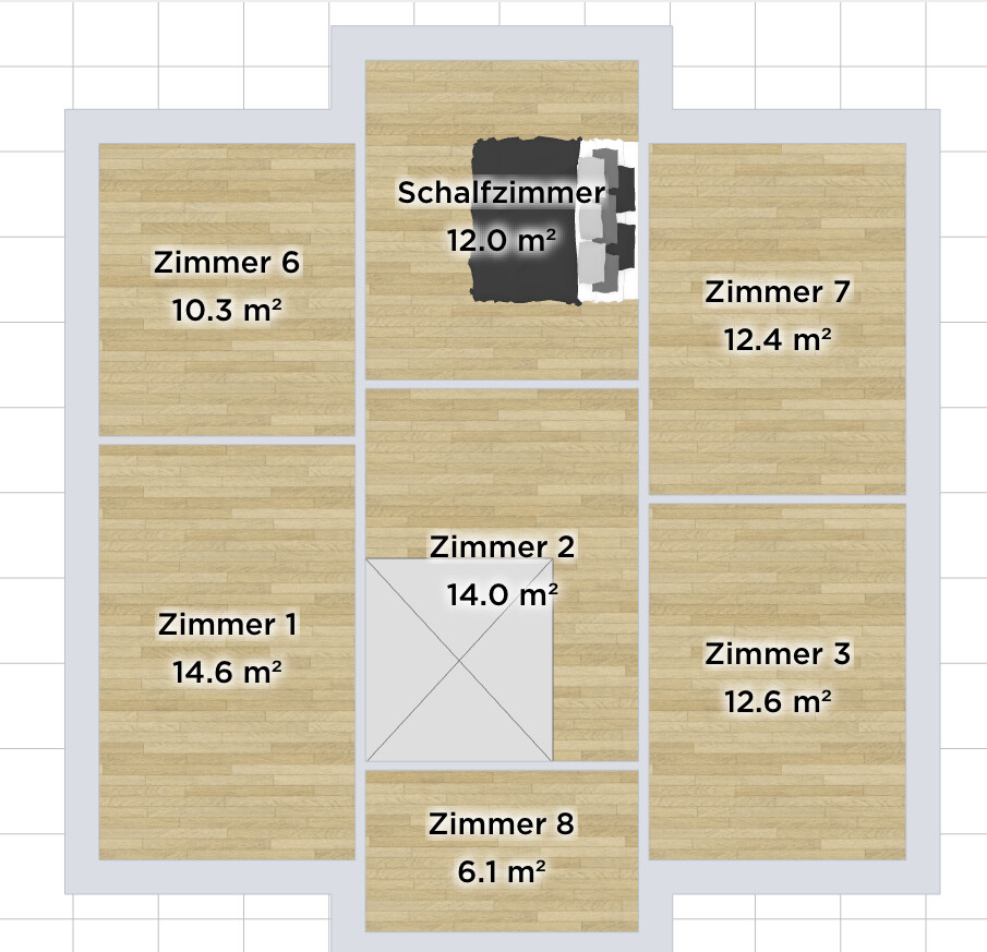

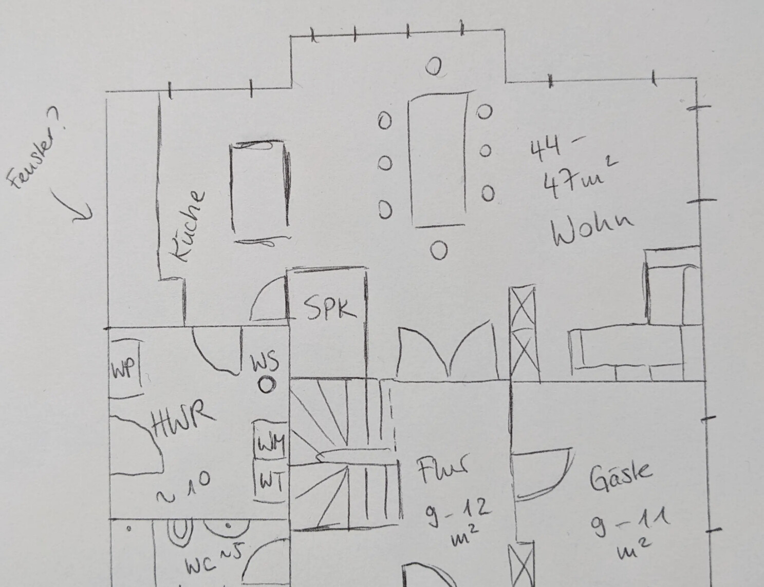

A layout similar to our hand sketch on page 23 was nice, but it resulted in children's rooms smaller than 10 sqm (108 sq ft) according to Wohnflächenverordnung (WoFl)—which we do not want. I had replied to your hand sketch on page 23
in #167, but refrained from posting the drawing I created based on your hand sketch with the given external dimensions (I recall you wanted to use the measurements provided by the general contractor).
So here again are the images of your hand sketch related to the external dimensions, as I made them, which have not yet been deleted:
For me, this is far from feasible, spacious, or anything positive. Too many rooms, a pantry that blocks any sight lines, and an additional partition wall that only confines the open-plan space. And yes, the room sizes given above are only floor areas...

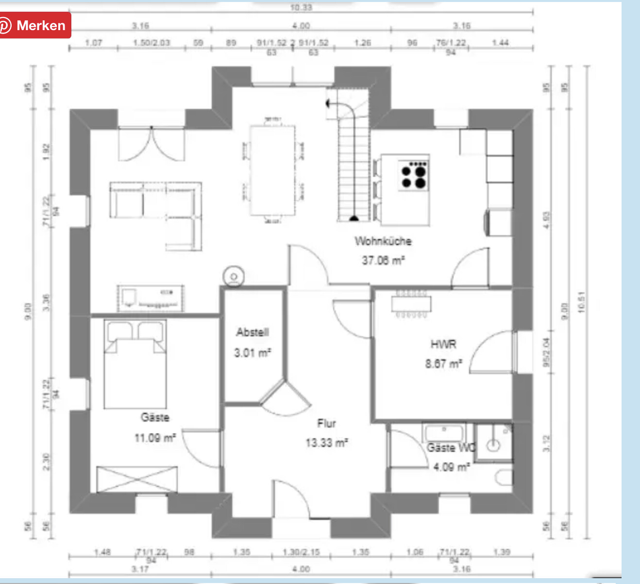

Did you copy the “151er” plan from Planerei? It is considerably wider than what you want. Whether it fits your plot or your budget, I cannot track anymore. Personally, I find little appeal in that design if you want it open.

The exterior dimensions are not fixed; the floor plans from the general contractor were just examples. If they are considered set, there must be a misunderstanding or you are mixing us up. The hand sketch doesn’t fit with that either. It will be a custom design, and more important than the exterior dimensions is that we can have reasonably good room sizes without the total area exceeding about 160sqm (1,722 sq ft).

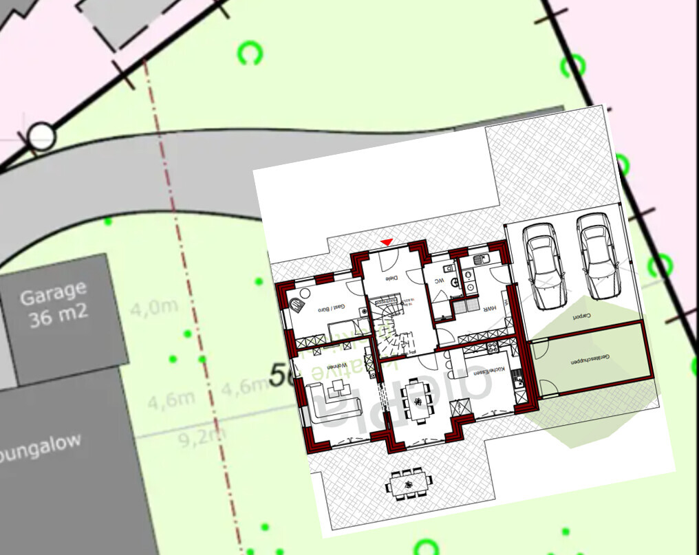

The setback on the west side results from a new property boundary after subdivision. From west to east, we have about 22–23m (72–75 ft) of space and need to maintain the usual 3m (10 ft) distance on both sides. The two plans are roughly comparable to ours with about 160sqm (1,722 sq ft). It’s very hard to come up with ideas because, for obvious reasons, most don’t build with two gables. That huge hallway really is something else, and we have given up on the open void space—better to have a tiny storage room instead. I’m going crazy trying to compare the sizes since sometimes the figures follow the living space regulation and sometimes they don’t :/ Thanks a lot for the placement sketches! We like that both create larger rooms upstairs.

Thanks so much for your work; it really puts things into perspective. Especially the upstairs floor areas are frustrating. The pantry should be integrated into the concrete staircase; that wasn’t clear in the hand sketch. All plans we look at assume that partition walls with sliding doors in the open plan won’t be used here. Is there another term besides “four-gable house” for this type of house, or are there just very few people crazy enough to want it like this?
