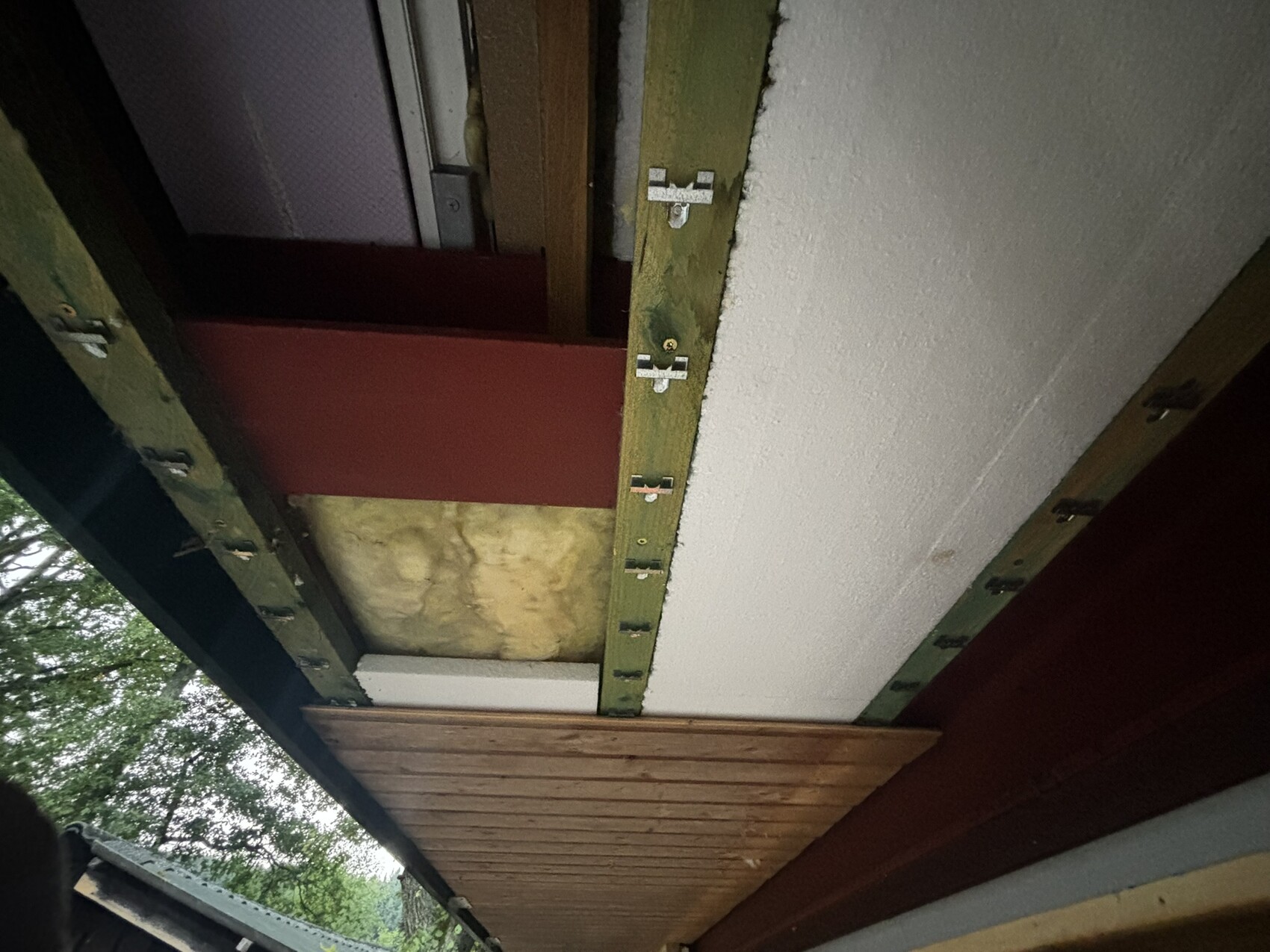

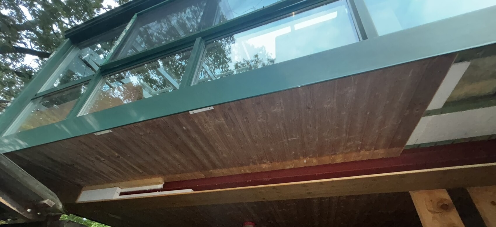

we have a detached conservatory and want to renew the floor there. We are considering the best approach for insulation.
Current situation:
- The structure is supported by a steel beam construction, fully lined with wood
- The current floor covering is 11mm (0.4 inch) thick click-lock linoleum

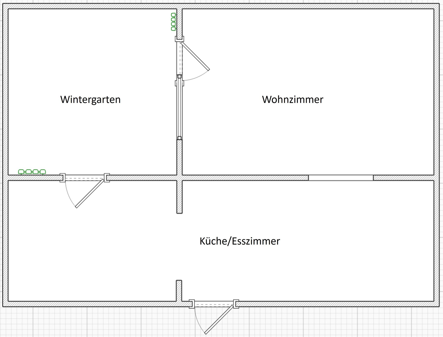

- The floor is very cold and not walkable without shoes except in summer. Even with shoes, you notice significant cold coming from below after some time
- The conservatory is connected to the building/bricked wall on two sides and has two large doors leading into the living area (kitchen + living room)
- It is currently heated with two vertical tubular radiators (relatively flat)
Overall floor structure:
- I have visualized the current overall floor structure
- The glass wool insulation is placed in the steel beams between the two flanges, though I couldn’t illustrate that better
- The photos show the structure clearly
Now we are wondering which type of insulation would be best to make the floor warmer. We can build up to a maximum of 50mm (2 inches) higher, meaning about 60mm (2.4 inches) from the top edge of the OSB board to the finished floor surface (no higher is possible due to the upper edge of the glass profile of the conservatory).
The final floor covering is not decided yet, and we would appreciate recommendations. We can imagine bringing the adjacent living room floor to the same height and using the same flooring there.
Does it make sense to remove the entire bottom lining and change the insulation there, or would the effect probably be minimal? (my assessment) I could imagine laying 40mm (1.6 inches) EPS 035 insulation on top of the OSB boards and then installing the new floor on top. It would also be possible to integrate underfloor heating if it can be reasonably fitted within the 60mm (2.4 inches) build-up including the floor covering. This would of course create a larger heating surface in addition to the radiators and could counteract the cold floor.
Some changes could be made from above and below, but from below it would be quite a lot of work to remove the entire lining.
I would be grateful for any advice or tips.

why is it that conservatories tend to stick to solutions that basically ignore the weak spot of “cold from below”? Your feeling that a noticeable improvement only happens when you address the issue from underneath is quite accurate. Especially: The glass wool in such an open steel-wood structure often performs much worse than expected, because countless perforations, leaks, and thermal bridges are almost impossible to avoid – so the effect of additional insulation on top is often just cosmetic. If you already have everything opened up, it really only hurts once – afterwards, the cold is gone!
Underfloor heating is charming, but with a maximum of 60 mm (2.4 inches) it becomes a real DIY solution with a dry screed system and thin insulation. You should not expect much comfort, because you are working with little thermal mass and the heat quickly escapes downward due to thin insulation. The hard truth: Without significantly thickening the floor from below, you only make real progress if the outside-air side is perfectly airtight and permanently dry.
Regarding the top covering: EPS 035 would be cost-effective for insulation, but consider the compressive strength if you want to install a hardfloor surface. With planks or click vinyl on top of insulation, the craziest things happen if it’s too soft. Floor covering – tastes vary, but a nice, continuous design floor or wood are certainly the most comfortable solutions. At the transition to adjacent rooms, I would always recommend installing a good profile to avoid tripping hazards and rattling gaps later.
To me, it sounds like you are hesitant to fully open from below – nevertheless, explore how complicated it really would be. Often, it is enough to remove individual panels and replace the glass wool cleanly with higher-quality insulation boards (for example, XPS, size depending on the structural depth) with precisely cut adhesive and sealing tapes to bring significantly more comfort.
Good luck!
