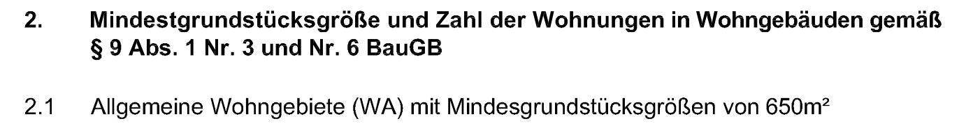

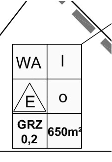

DNL schrieb:
Who can tell me what the maximum plot size allowed is for this location? Is the building authority the right contact for this? The neighboring plots are smaller, but that doesn’t necessarily mean much.
They should actually know that. It should also be stated in the development plan, which is often available online on the municipality’s website. But you should ideally already have this document.
For example, this is documented here:
If I were you, I would take another look.
Also, check the floor area ratio to see how much you are allowed to build on a 450m² (4,840 sq ft) plot.
As a rough estimate, more is usually possible in inner-city areas than in suburban or rural locations. In the countryside, the overall appearance is typically expected to be more open and spacious.
