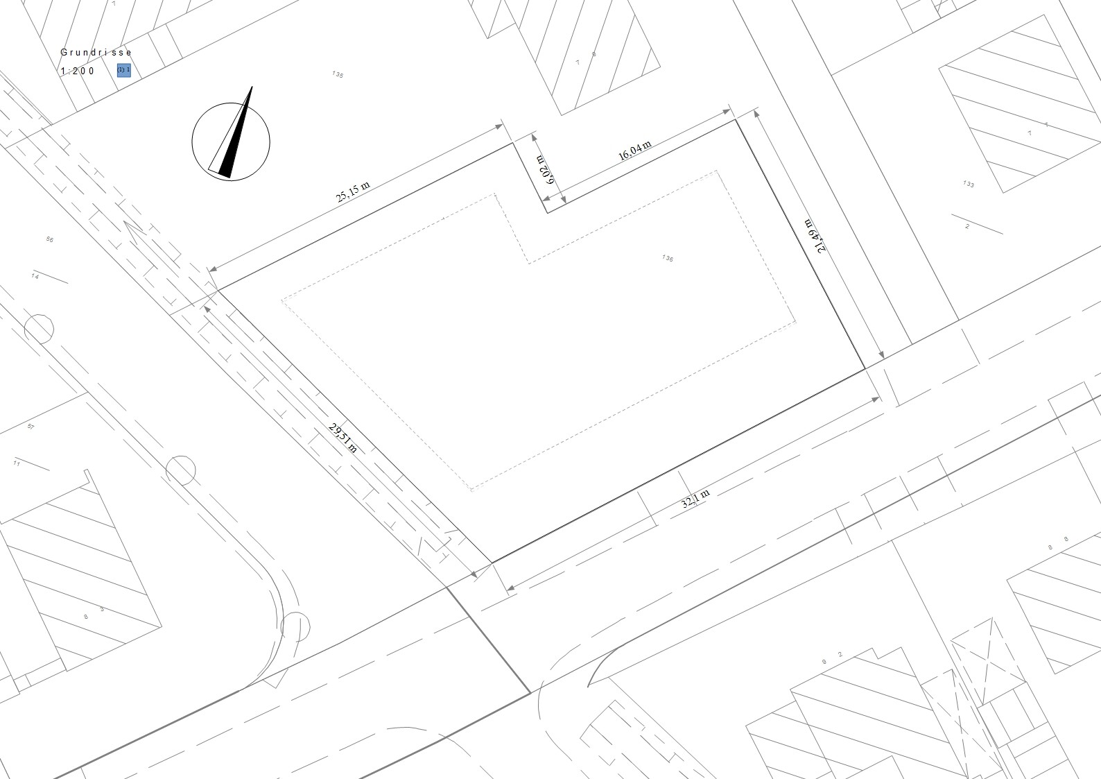

I would like to ask for your suggestions on how to divide the attached plot of land into two equal parts.
The plot measures just over 900 sqm (about 9,688 sq ft). It should be physically divided into two equal sections and developed by two families who are friends.
On the left side (southwest), there is a ditch next to the plot and a road beyond that. At the bottom (southeast), there is also a road.
The dashed line indicates the building area, which is determined by a 3 m (10 ft) setback from the property boundary and a 6 m (20 ft) non-buildable strip facing the road.
Access is from the road at the bottom (southeast).
Unfortunately, the plot is somewhat irregular in shape. We have tried many options already, but I would appreciate unbiased suggestions.
I look forward to your proposals.

So far, no one has raised any concerns about the subdivision: the land registry office, the architect (who has also been to the building authority and the dyke authority), and the local surveyor. The development plan does not indicate anything to the contrary. Therefore, I assume it will work out. Only the question of “exactly where to divide” still raises some issues.

I would consider building a semi-detached house, as this would give you the advantage of larger, contiguous garden areas that are more usable. One unit would have a terrace facing southeast, the other southwest. The division would logically be along the shared side wall running north-south. Additionally, building a semi-detached house could help you save some costs.
