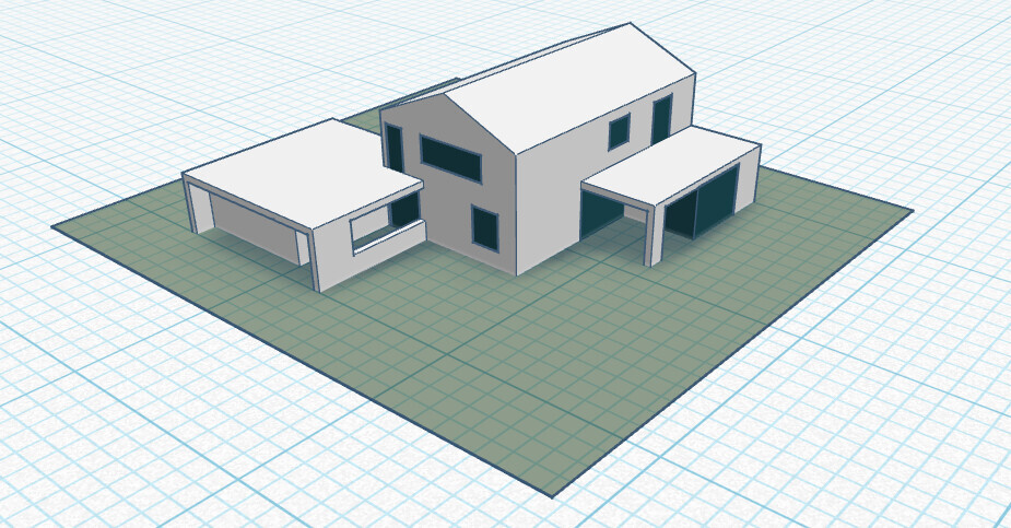

Regarding the orientation on the plot, does the picture help?
@11ant
You are of course right; this would be a shell construction general contractor. I described it incorrectly.
And yes, there may have been some issues in the planning or process.

vineyard9 schrieb:
Regarding the orientation on the plot, does the picture help?Unfortunately, there are no elevations indicated either as contour lines or points. vineyard9 schrieb:
And yes, if necessary, something may have gone wrong in the planning process or workflow.I mention this because it is a very common mistake to present draft drawings too early. On the one hand, it wastes time, and on the other hand, it wastes even more time. Firstly, because this step can be taken earlier. Secondly, because feedback at that stage can provide insights that are much harder to incorporate later on. That is why the “resting period” in my house building schedule has a fixed place between Module A and Design Phase 3 (and the key decisions are made during this resting period). Submitting the preliminary inquiry later, as explained above, costs time (and therefore money, considering construction cost inflation). Besides, we are currently living in a time of great uncertainty, where new regulations and application deadlines for subsidy programs can be introduced by the government at any time. derdietmar schrieb:
But the financing is unrealistic. Construction costs of 3500 euros per square meter already amount to 700,000 euros for the building without the basement. And many things are still missing, not to mention the exterior works.
The basement, including excavation and interior fit-out, will definitely cost between 70,000 and 100,000 euros. Of course, the question of the basement should be clarified even earlier (before finalizing the room program layout into a building structure in Design Phase 2).https://www.instagram.com/11antgmxde/

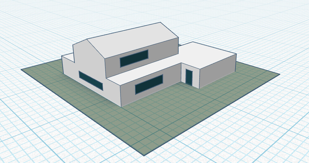

derdietmar2 Jul 2025 12:09Hello,
The garage could be moved forward by about 5m (16 feet). This would create space at the back for the enlarged extension.
