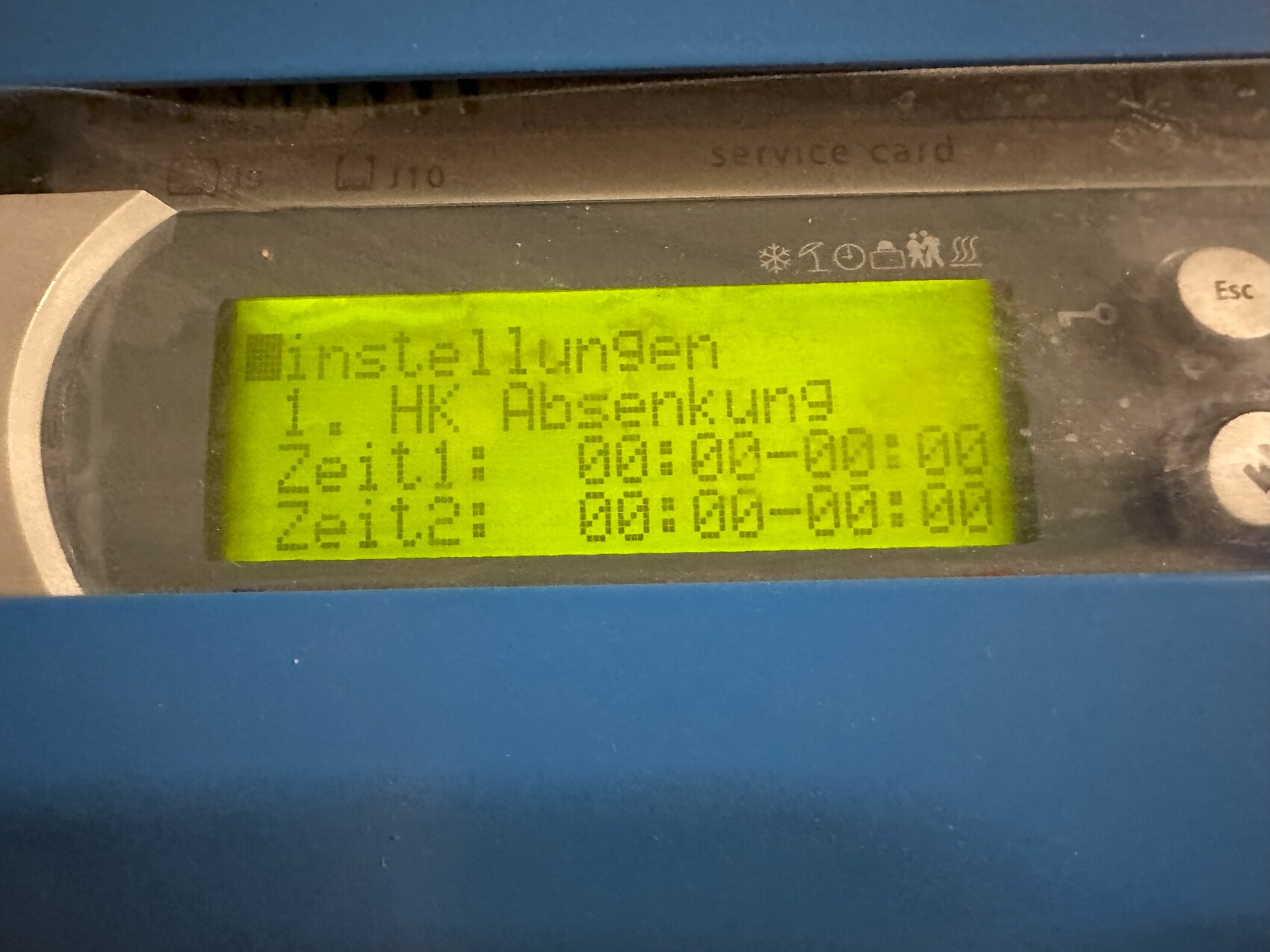

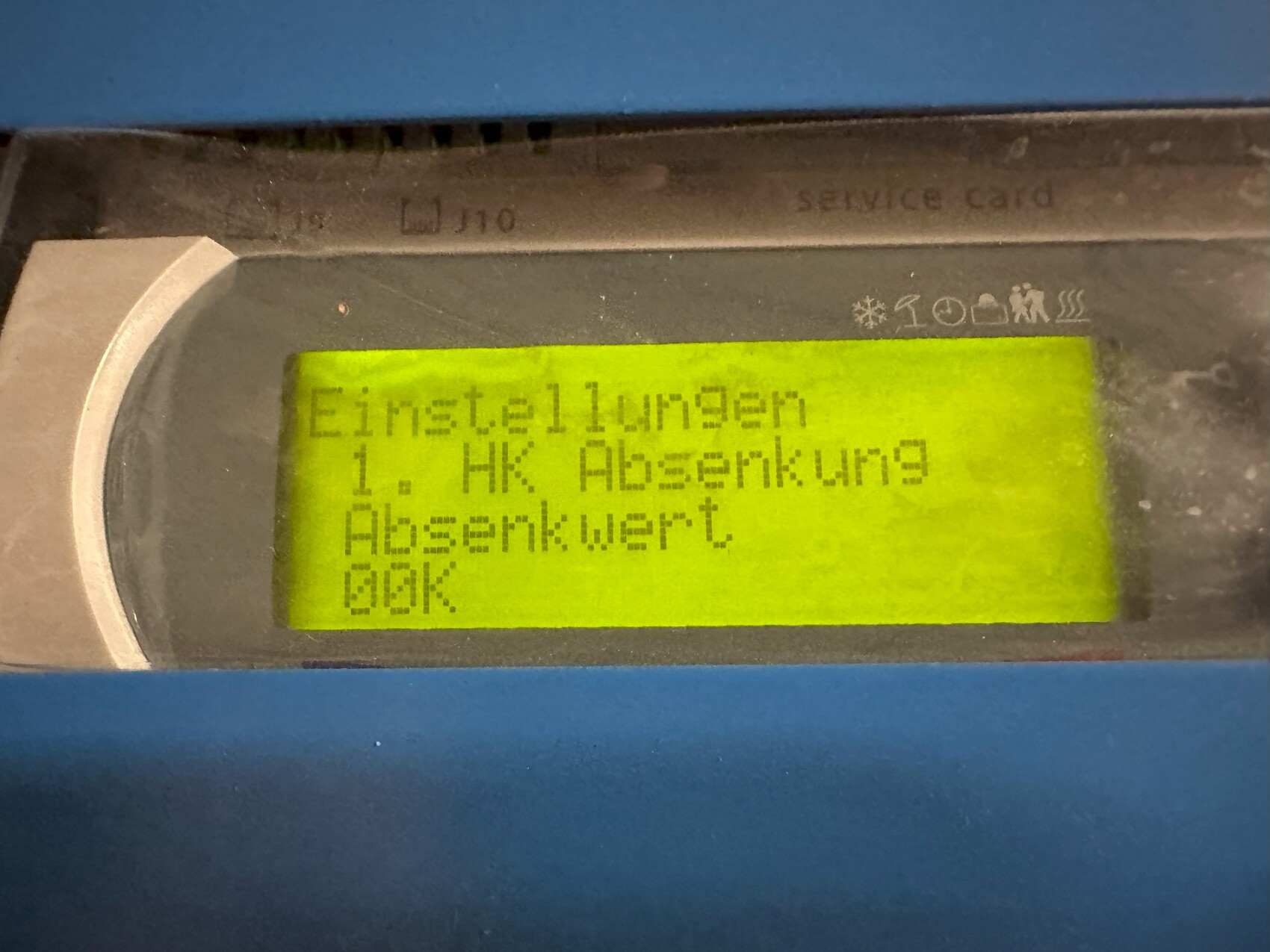

Your data looks like some kind of system takes a break before 4:00 AM, then starts a regular cycle again.
My guess, and that of some previous respondents, is that this cycle consists of heating, reaching the set temperature, heating off, temperature dropping below the set point, heating on, reaching the set temperature again, heating off, and so on. There is a pause before 4:00 AM. This can be described as a nighttime setback. You can see this from the data, regardless of what makes sense to you or not.
And honestly, you are one of the most unpleasant questioners I have come across in the three years I have been reading here.

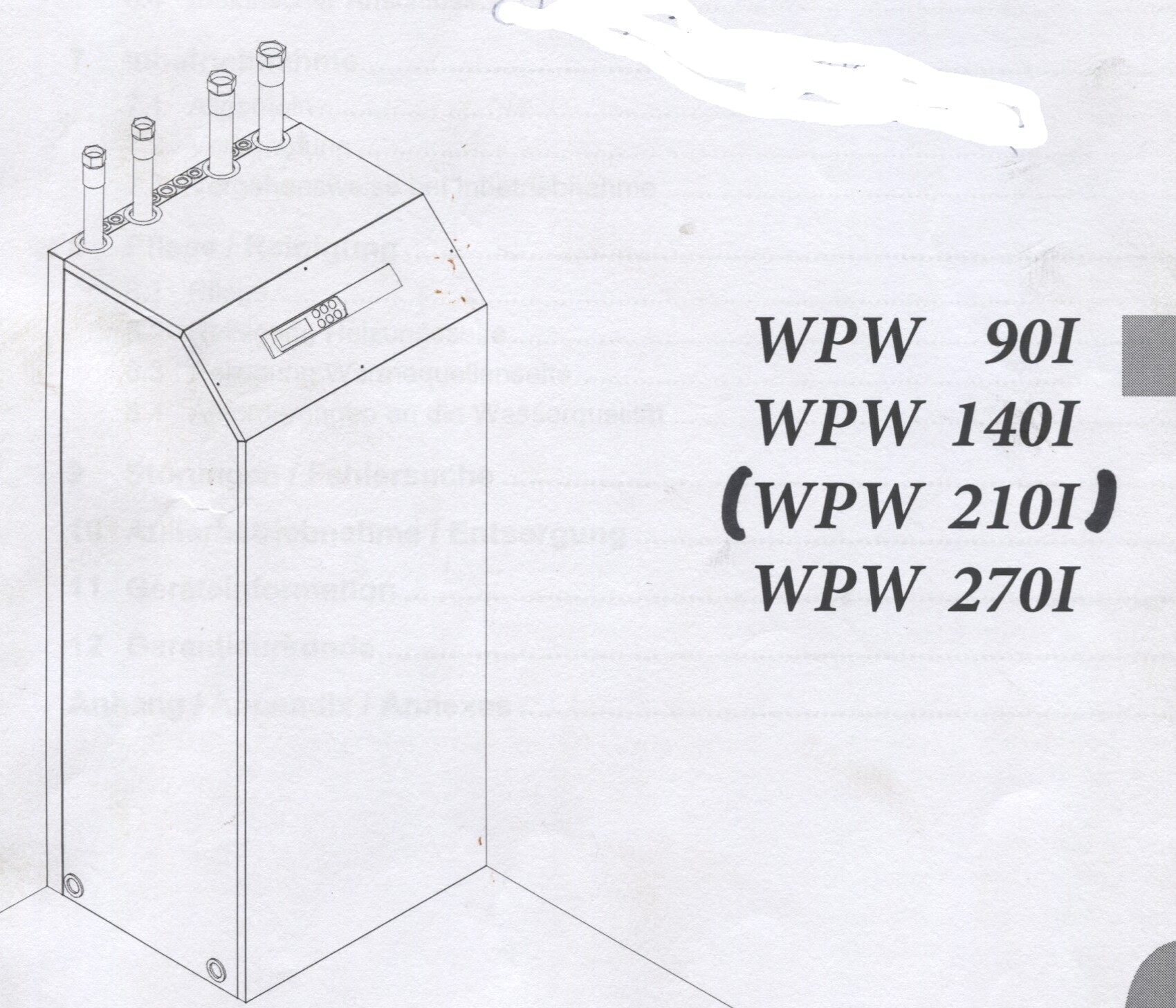

You didn’t mention the model name, which is of course important when looking for the user manual.
Logafix WPW seems to be an older model. Which one exactly?
WPW 440IP, WPW 920IP
WPW 90I, WPW 140I, WPW 210I, WPW 270I?
Which controller/regulator?
I only find RC100 and RC310, but they appear to be more recent versions.
