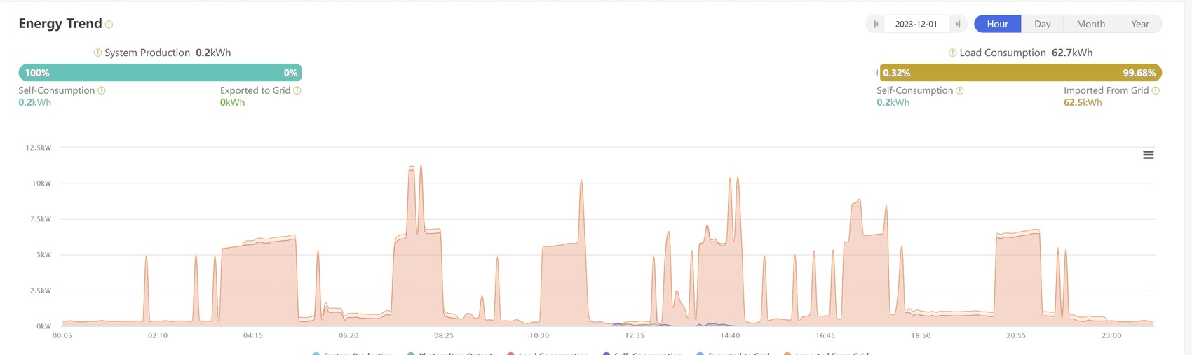

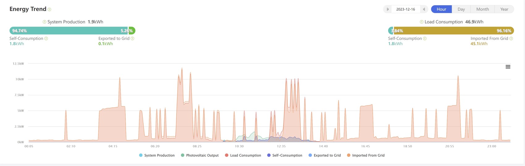

We have a groundwater heat pump, an electric heating element for hot water, and a 10 kW solar system with a 25 kWh (27 kWh) battery storage.
Now in winter, the solar system produces practically nothing. The electricity demand is supplied from the grid.
The system shows the daily electricity consumption.
What I don’t understand about these curves is the electricity demand around 4:00 AM. At that time, we are sleeping, and except for the heat pump, no electricity should be needed. I am not aware of any timer switch that turns anything on at that time.
What could that be?

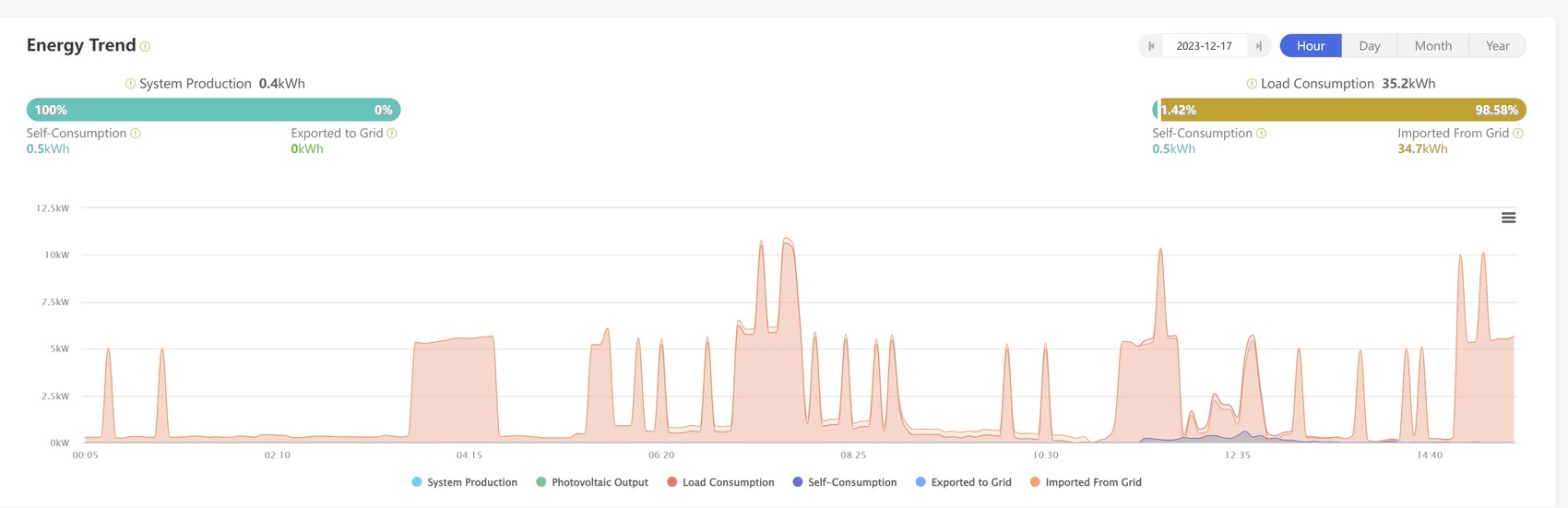

marienschatten21 Dec 2023 06:56The heat pump heats the water up to a maximum of 40°C (104°F), which is not sufficient for disinfection. The electric heating element is limited to 55°C (131°F).
As suggested, I set a night setback. This actually caused a change in the curve.
So, my problem seems to be related to that after all. Since there was no night setback set before, something is wrong with the control system. I am now scheduling an appointment with the heating technician. They will either reconfigure the entire control system or replace it completely. Then, finally, there will be peace and unwanted electricity consumption will be prevented.
