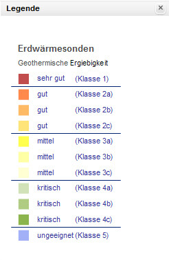

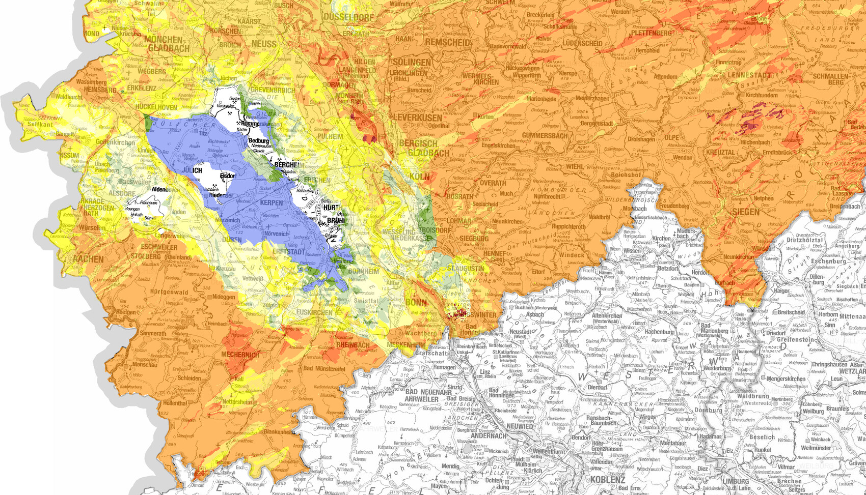

Ecart19 Oct 2015 21:13
Official links, for example from KfW Bank, the Geological Survey of NRW, etc., should generally be allowed.
This would provide added value for many readers. If not desired, I will refrain from these activities here in the forum!
Color-coded map of North Rhine-Westphalia with zone colors and city names.
Legend for geothermal probes with color codes and assignment
