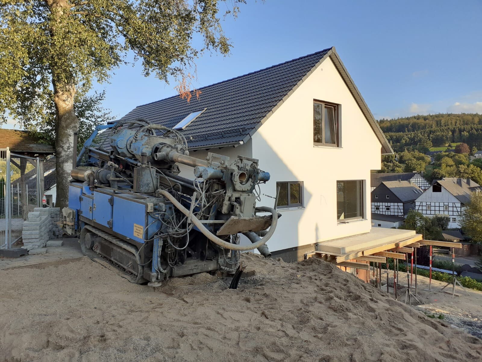

Enjoy the lack of an outdoor unit – I find decisions like that practical in real life, at least in private homes. I’m personally happy about it too! I don’t know if @009_frank finds the missing economic viability just as pleasing. If yes: go for it – there’s nothing better than a 140m (460 ft) deep hole in front of the house.
