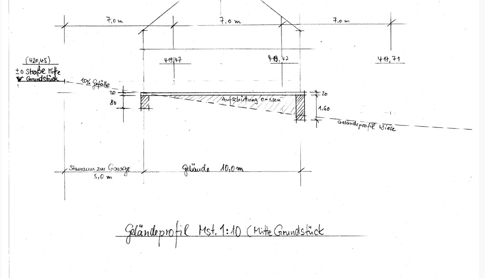

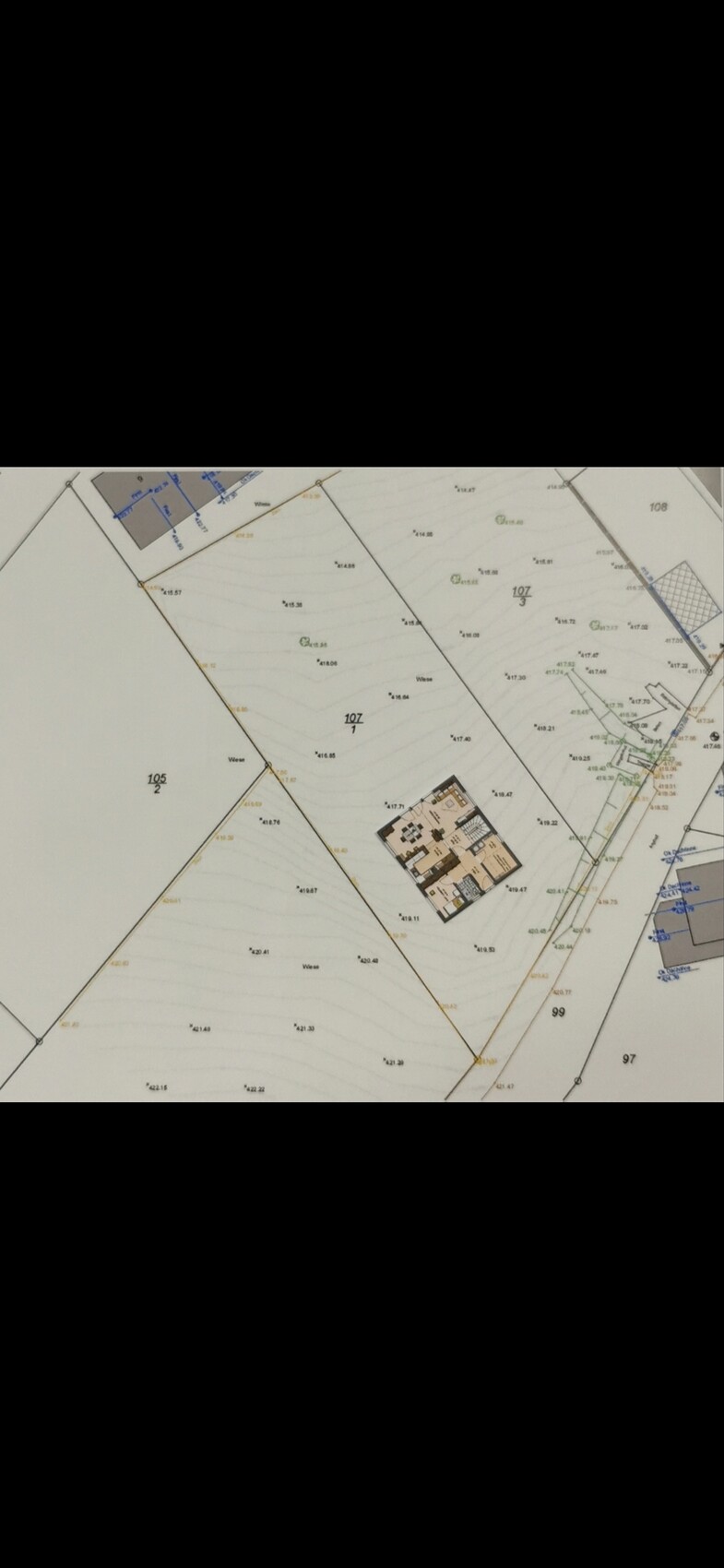

Builders and excavation contractors are currently hard to find, and I have attached photos of what we have worked out so far.
Do you think the project without a basement, as shown in the drawing, is feasible? Also, what costs should I expect for earthworks, filling, and compaction? Since a carport is planned to the right of the house and a terrace to the left, these areas would ideally need to be prepared and filled at the same time.
