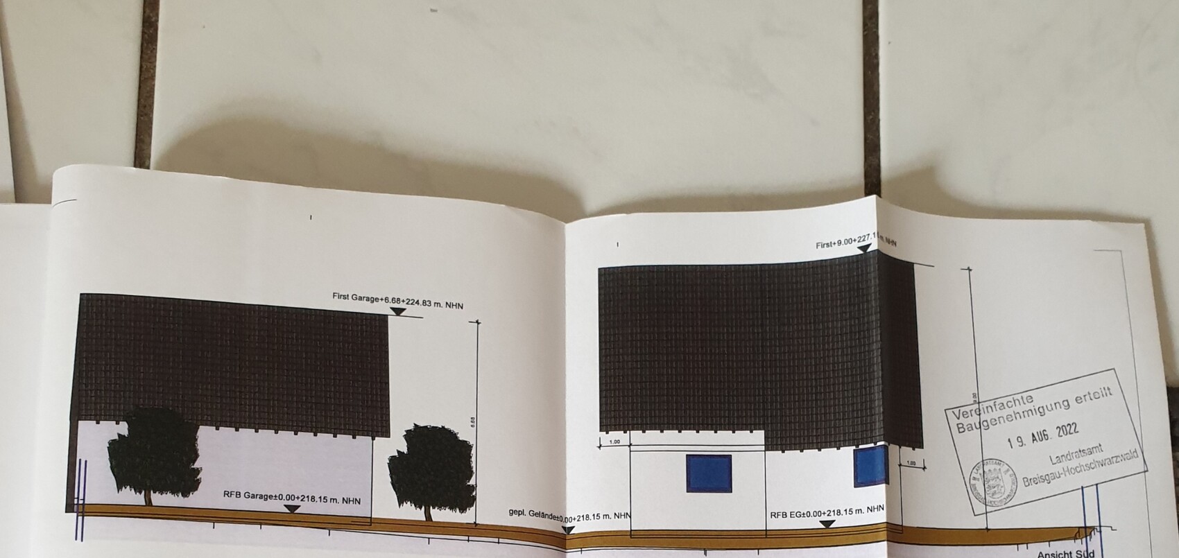

In picture 1, you can see the house roof facing south, so it gets sunlight from morning until evening.

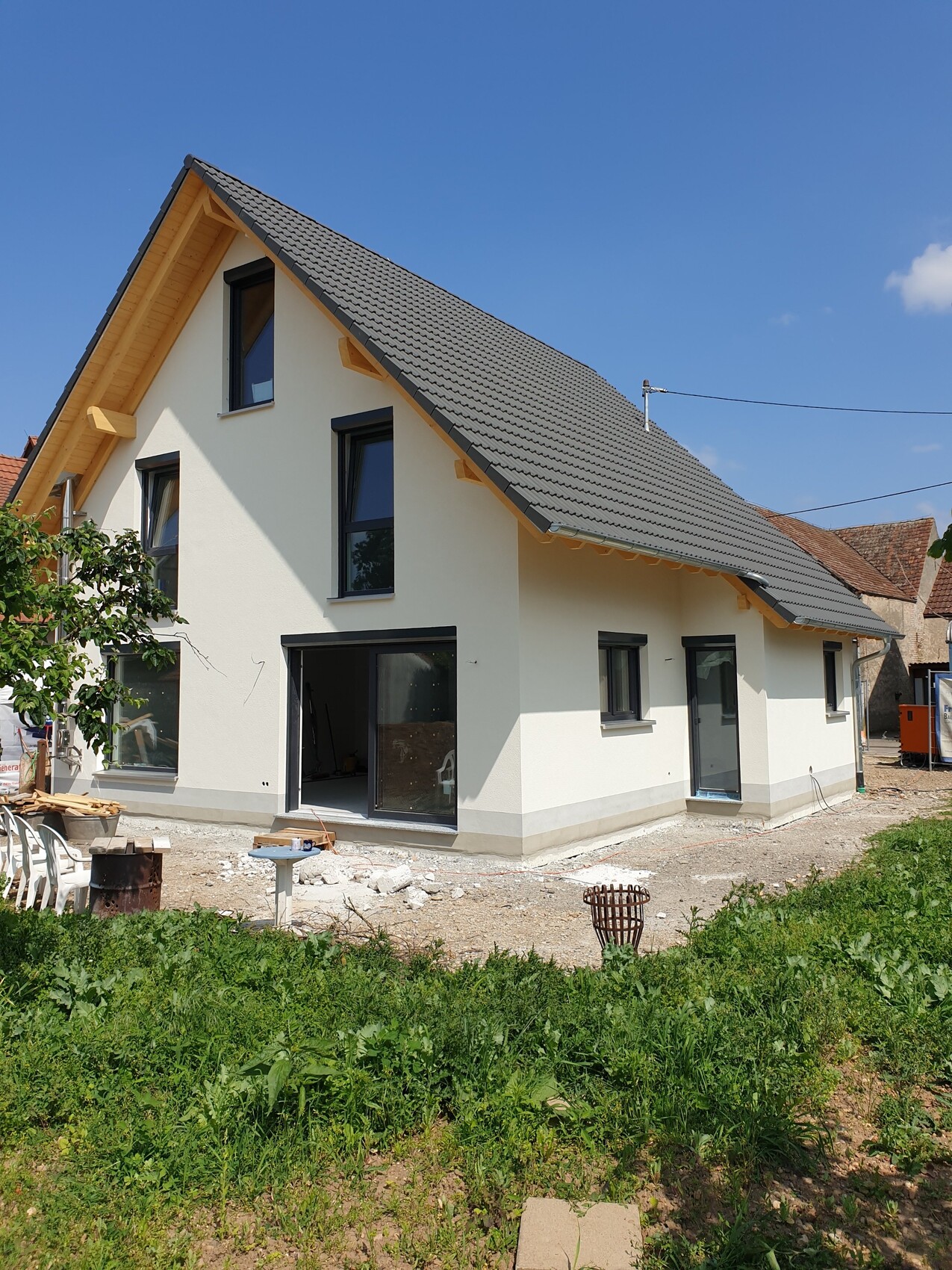

The garage is located in the back corner of the property, also facing south, as shown in picture 2.
The south-facing roof area of the garage is 60 sqm (645 sq ft).

danielg406 Apr 2024 22:46I actually need to check if the house casts any shade on the garage roof; I don’t think it does since there are 9 meters (30 feet) between the house and garage. I’ll keep an eye on that.
In the past few days, I have applied a protective finish to the rafters and purlins; we’ll install them in about 2 weeks. Then it will be clearly visible. I’ll send another picture at that point.
