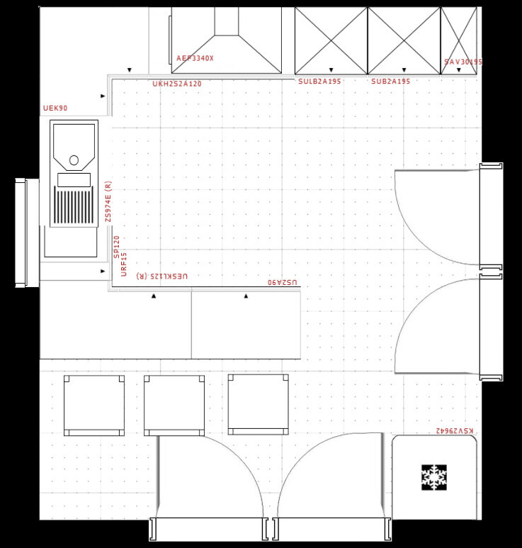

denz.
28 Nov 2017 15:27
We originally thought the kitchen was quite large and that an island would work well, as it would allow a view into the living room while cooking. However, after experimenting a bit recently with a kitchen planner, I realized it would actually be quite tight.
I tried out a few different layouts.
Floor plan of a workspace with countertops, chairs, doors, and a machine.
Regarding the niches: after reducing the upper floor (see post #7), the niches no longer exist.
As mentioned, this is all still just our amateur planning so far.
