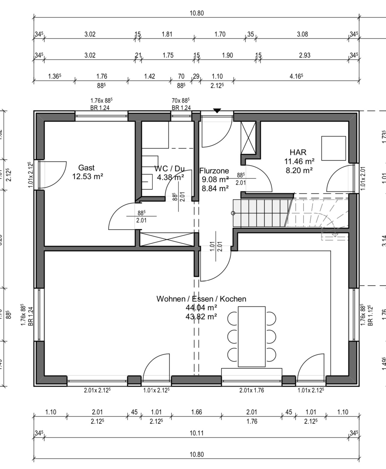

I would like to share my floor plan here to get some feedback for optimization. We are already quite far along in the planning process and are generally satisfied. However, we can still make minor changes without any problems.
A brief introduction about us: a family with two children (2 and 4 years old). I work full-time without working from home, and my wife is currently not working but plans to return to part-time home office work in 1-2 years.
Mainly, my focus is on the window planning and the layout of the bedroom and bathroom. Regarding the windows, we wonder if there might be too many and whether that has significantly increased the costs.
Children’s rooms:
Do we still need windows facing east/west? This is probably a subjective question, but I’m happy to hear your opinions.
Bedroom:
Are windows facing north or west unnecessary? Alternatively, we could consider moving the partition wall so that the dressing room’s window also provides light to the bedroom.
Bathroom:
I’m wondering if the layout can still be improved, for example, by using a T-shaped design. We also have the issue of an extra window next to the toilet, primarily for ventilation. The window above the bathtub is not ideal for ventilation as it is hard to reach.
Any general comments are also welcome if something looks generally unfavorable.

JoschNeubau242 Jan 2025 21:10nordanney schrieb:
Ok. This was not planned that way.
However, 45cm (18 inches) is too little to sit comfortably. Apart from that, the dining table then has to be almost completely pushed against the wall (as shown in the photo).
The example in the photo is not suitable for the dining table. Here is the ground floor plan with the dining table drawn in. When positioned lengthwise, it should be easy to get in and out.
This is too vague. How long is the table with the six guests shown, and exactly how far is it from the outer edge of the 30cm (12 inches) deep window seat, so that one could sit there reasonably comfortably without having to move the table? How much space remains on the other side, for example, when the fridge or kitchen cabinet is open? This would be the only access to the kitchen!

JoschNeubau242 Jan 2025 21:45Arauki11 schrieb:
That’s too vague. How long is the table with the six guests shown, and exactly how far is it from the outer edge of the 30cm (12 inches) deep window seat, so that it’s comfortable to sit at without having to push the table? How much space remains on the other side, for example, when the fridge or kitchen cabinet is open? That’s the only access to the kitchen! I don’t remember the exact measurements, but the length should be around 1.80 m (5 feet 11 inches). If the window seat protrudes 30 cm (12 inches) and the distance to the table is 10 cm (4 inches), that adds up to about 2.20 m (7 feet 3 inches). The room is 4.75 m (15 feet 7 inches) long, so about 1.35 m (4 feet 5 inches) remains when the fridge door is open. This is a rough estimate, but it should actually work.
JoschNeubau24 schrieb:
Distance to the table 10cm (4 inches)Really, is that enough? I just noticed that the kitchen is 60cm (24 inches) deeper.
Again, I’m not trying to discourage you, but it definitely won’t be comfortable, and I don’t understand why anyone would narrow an already tight space even more—this also applies to the budget regarding a controlled residential ventilation system in a KfW40 new build.
I would carefully and honestly reconsider all the other points mentioned here BEFORE starting.
Above all, I would discuss with my wife what regularly ventilating by opening windows several times a day over the next 30 years really means.
At first, you wrote about the table that it “should” fit, but later you said it “does” fit. I would check that very carefully.
