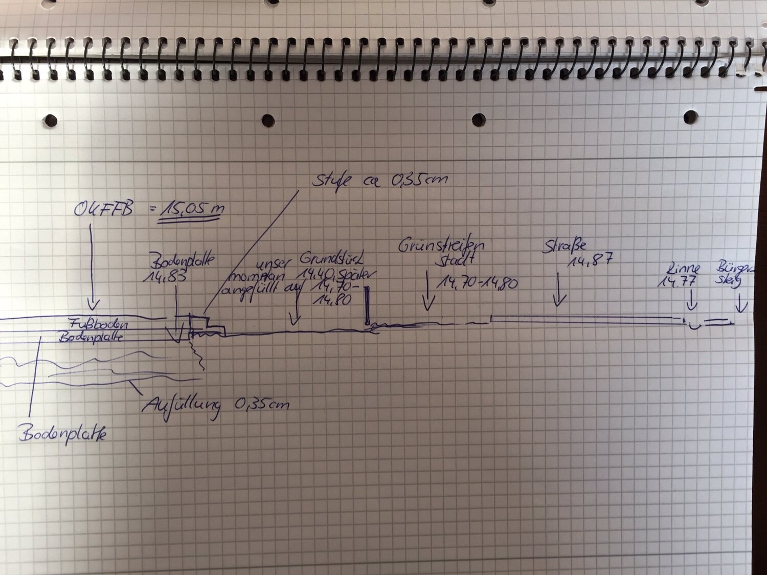

We received our building permit / planning permission two weeks ago. It includes a recommendation to raise the house by an additional 25 cm (10 inches), but this is only a suggestion. However, it is a bit unsettling. Currently, the plan is for the finished floor level to be 15 cm (6 inches) higher than the street level. I actually thought this would be enough. The street is about 10 m (33 feet) away and slopes down towards the opposite side of the street.
What do you think about this?

winnetou7830 Sep 2017 16:28I'll make a sketch and see if I can manage it.
winnetou7830 Sep 2017 17:01W
winnetou7830 Sep 2017 17:02And the distance to the road, as already mentioned, is 10 m (33 feet).
winnetou781 Oct 2017 08:54Is my sketch really that bad?
