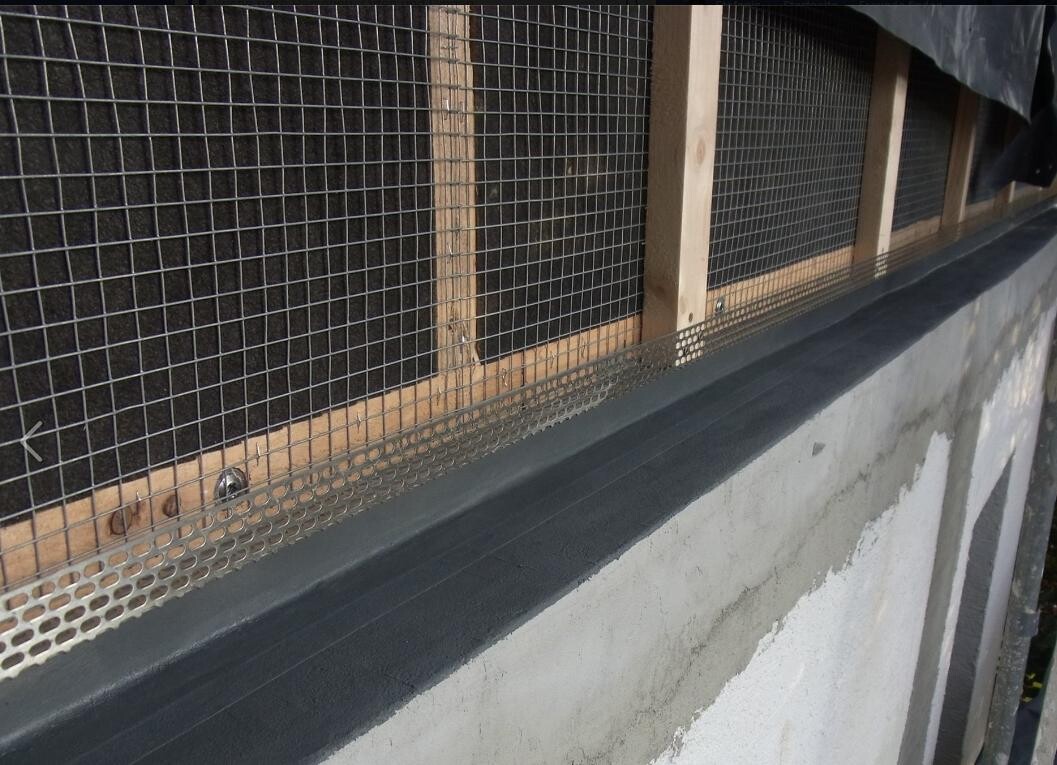

I would hang a building membrane (house wrap) on the facade first. We use fleece-faced mineral wool boards, which are water-repellent, but in areas where we hadn’t yet attached a square wire mesh, it was clearly visible that birds used the insulation as nesting material—they simply picked it out. Mice are interested as well... if the insulation is exposed, it would likely be torn apart or something would nest inside it. That’s why we install the square wire mesh directly over the insulation, then the battens, and additionally insect screens at the top and bottom.
