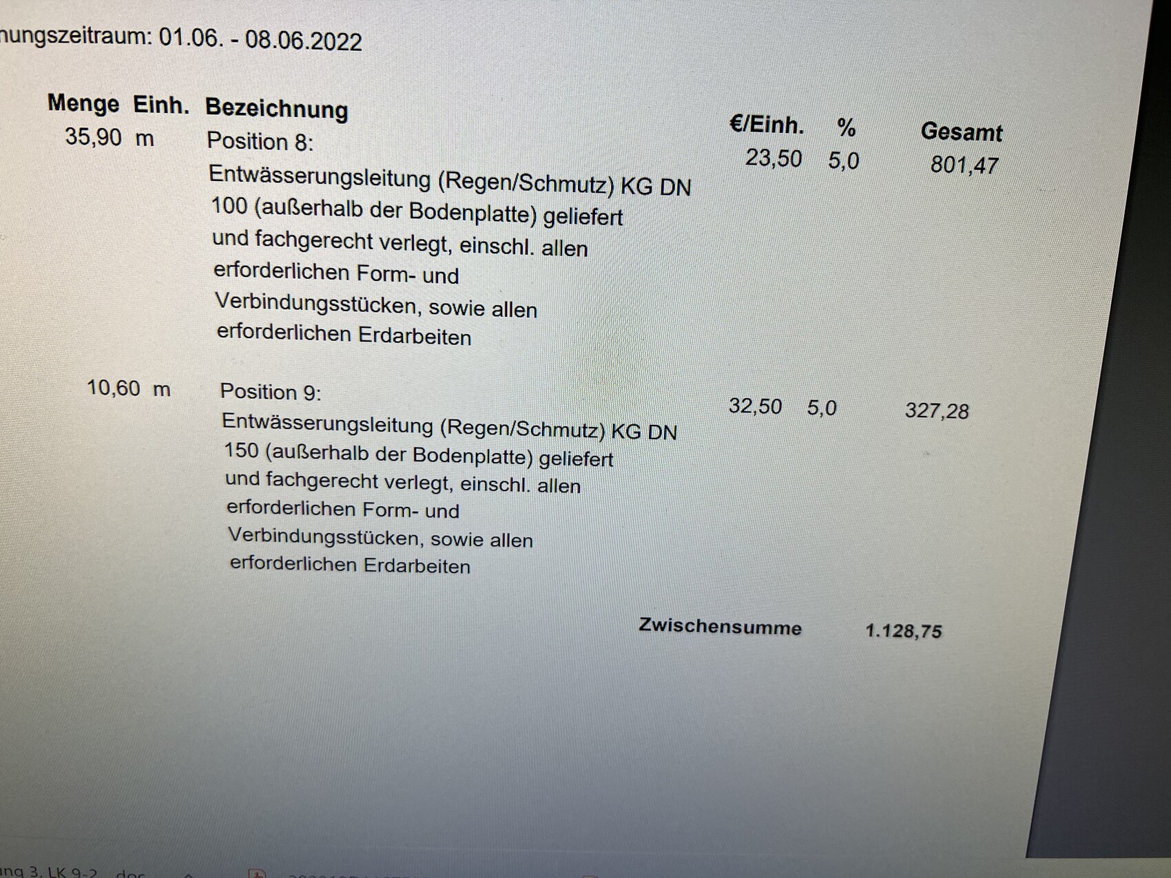

Stromfresser20 Sep 2022 07:57Tolentino schrieb:
I think everything except the pipes is fine. The pipes are about twice as expensive as mine. However, it could be that the material prices have just jumped up again; I don’t really follow that.I agree – the price is excellent! Material costs are very difficult right now.
Xephar0s schrieb:
Honestly, I find it quite expensive, especially the pipes. About 4 months ago, we paid 23.50 € net per meter for DN 100 and 32.50 € net for DN 150.That must be for the pipe only, but not for pipe plus installation, right?halmi schrieb:
for the pipe, but certainly not for pipe installation as well, right?Yes, both for the pipe and for the installation.
