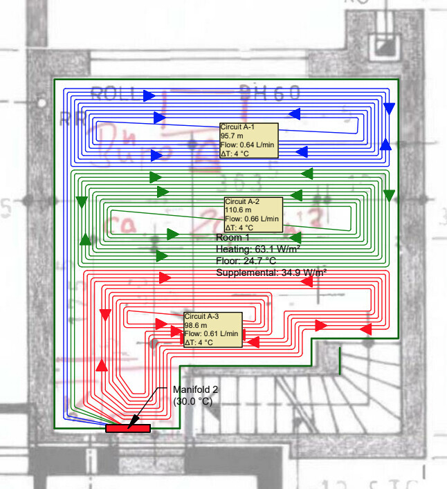

Example from one of my rooms: 5cm (2 inches) pipe spacing for 20 sqm (215 sq ft) results in about 300m (985 ft) of piping over three circuits. Along with the layout plan including hydraulic data. The target room temperature is 22°C (72°F). Supply/return temperatures are 30/26°C (86/79°F) as maximum values.
I definitely have it calculated.
Shouldn't 5cm (2 inches) spacing require about 20m (66 ft) of pipe per square meter, so for your 20m² (215 sq ft) it would be closer to 400m (1,312 ft)?
Why are there areas in the middle that aren’t spaced as closely?

Example of one room in my case. 5cm (2 inches) pipe spacing over 20m² (215 sq ft) ==> 300m (984 ft) of pipe with three circuits.

jens.knoedel20 Dec 2023 12:01All values are always approximate. There isn’t that much pressure on the walls or in the center of the circles. The possible bending radii (with my 16mm (5/8 inch) pipes) determine the center for me. It’s simply not possible to install more piping there. This can also be seen clearly in the installation plan.
