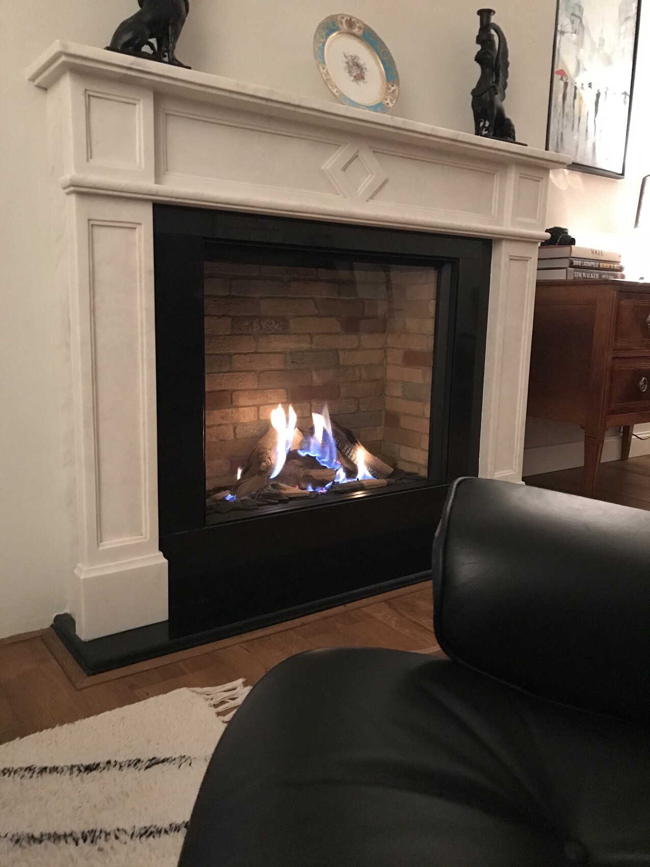

Just because the initial cost might be a bit lower? The initial cost is lower, no annoying humming noise, gas boilers are reliable and usually require minimal maintenance. Burning gas produces very little CO2 and smoke/soot (compared to a wood fireplace), which makes the neighbors happy.
...and while I type, I’m enjoying my gas fireplace.
