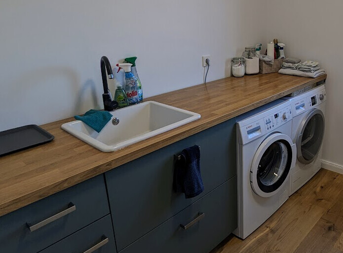

We did it this way because I prefer the look. The sink is also designed for the faucet to be mounted in the countertop behind it.
We haven’t noticed any disadvantages. You just need to seal it well, but that’s necessary around the edge of any sink.
The sink drain is not centered but positioned toward the back, so the faucet placement fits perfectly with that.
Edit: In the main kitchen, we have it set up differently. That is due to the farmhouse sink, which has a hole for the faucet. In my opinion, it really comes down to personal taste and doesn’t have major pros or cons. The only important thing is that the sink and faucet need to be compatible and designed to work together.
