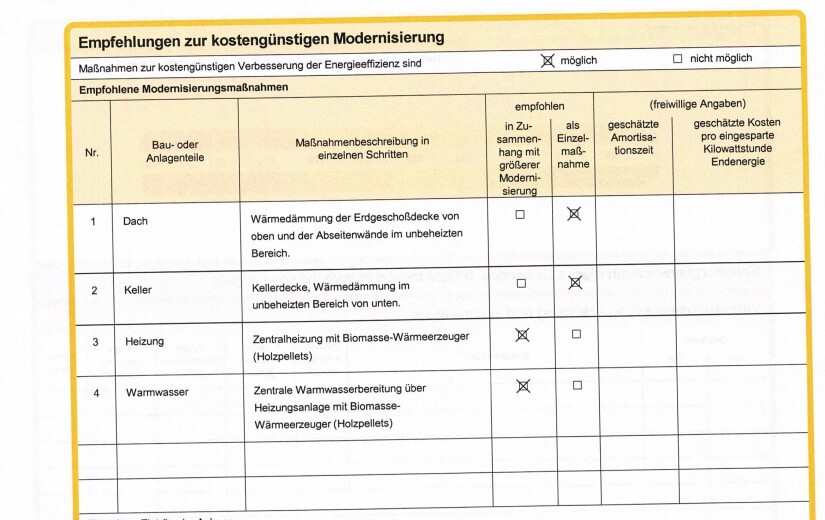

Please excuse me for not being able to send everything sooner:
Attached is the energy performance certificate. Unfortunately, the brochure has been removed. It is clear that the wooden insulated glass windows will also be replaced in the coming years, but not as a primary measure, since we plan to carry out everything gradually.
