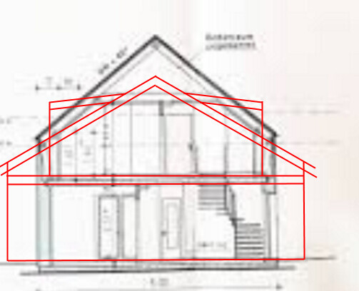

This is roughly how we live today: I would call it 1.5 stories. That would be acceptable.
Yes, I do expect a first response from the second provider after the holidays.
Cross-section drawing of a two-story house with stairs, roof, and window front

We still don’t know your requirements or the exact regulations of the development plan. Nevertheless, here is my summary based on the information so far:
Schematic drawing of a two-story house with gable roof and staircase (building plans)
In the area of the dormers (what size would be allowed according to the development plan?), there would be more space than in the existing structure. Even in the sloped roof area up to the relevant living space line at 1.50 meters (5 feet), there are no losses. Additionally, the ground floor is wider.
Of course, following your incremental approach, you might again quote some details from the development plan that make the above impossible or unacceptable. In that case, you really should consider releasing the lots again, because there are always countless arguments against any construction.
