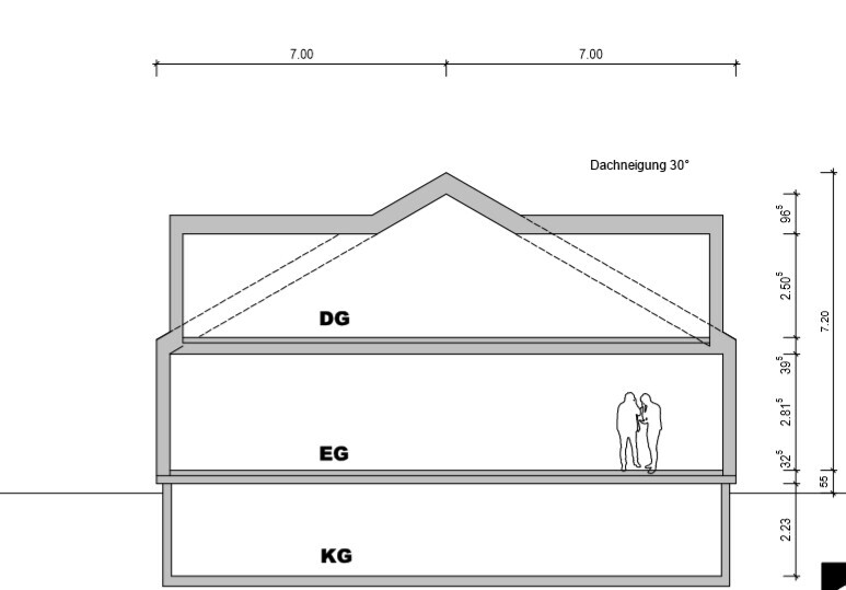

What am I overlooking here? Ideally, a house is designed according to the local zoning plan for the specific plot. If you roughly sketch the cross-section, with a house width of 10 meters (33 feet) and a knee wall height of about 1.50 meters (5 feet), you can still stay within the limits.
That is the art of planning—optimizing the design and using the dimensions effectively.
However, this requires not fixating on centimeters. An architect can design rooms with a ceiling height of 2.65 meters (8 feet 8 inches) that feel taller or more spacious than rooms with 2.75 meters (9 feet).
You can also influence the overall height of the house by adjusting the width... and anyone can draw 30 degrees: two squares to the left and one up.
nordanney schrieb:
Then you need to be creative when planning with your architect. With a ridge height of 7.20 meters (24 feet), you can still design something nice. The floor and ceiling structure just need to be optimized, or you accept 265 centimeters (8 feet 8 inches), which is already higher than ceilings in more than 90% of houses. I agree with that.
But if you have specific wishes you don’t want to compromise on and there is no pressure from the plot, then it’s better to reconsider.

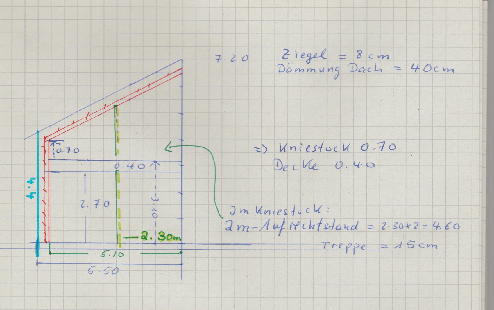

ruedigold24 Dec 2019 11:22@ ypg, that’s fine. I’m just having some trouble with the numbers. Following your advice, I drew a cross-section. The limits are at the top and bottom. Similar to Downing Street 10, I started from the specified top edge—which according to the building plan references the street surface (!)—added a stair step of 15cm (6 inches), and now I’m inside the house at floor level.
Now I want a ceiling height of 2.70m (8 ft 10 in). Above that comes the floor slab of 40cm (16 inches). If I measure from top to bottom, I first assumed the ridge tile is 8cm (3 inches), then comes the insulation (I think the rafters are in between, but I’m not sure). The insulation thickness I found online is listed as 40cm (16 inches). So together that’s about 50cm (20 inches).
When I measure this on my drawing, the knee wall height is somewhere around 70cm (28 inches). Question: how do you get 1.50m (5 ft)?
If I continue following my sketch, then the vertical height in the upper floor (and this is the way I want to calculate for now—see the Danhaus pictures for reference; children only visit us during holidays) is 2.30m (7 ft 7 in) on the left and right of the centerline, so combined 4.60m (15 ft 1 in).
Multiplied by the net depth of the house of 13.20m (43 ft 4 in), this results in about 60 m² (645 sq ft) of actual usable floor area on the upper floor—that is, “real” living space. For me, usable floor area means the rooms where I actually spend time, standing, sitting, or lying down. I thus stick to my earlier figure of 114 m² (1227 sq ft) plus the 60 m² (645 sq ft) now in the knee wall area, making a total of 174 m² (1873 sq ft). The knee wall area can still be improved further, since dormers are allowed.
Please note: this is my kind of worst-case scenario, because I don’t want to fool myself by assuming or presenting things more positively or imagining them better than they actually are on critical inspection. After all, I want to move in later and to know beforehand where the structural drawbacks are—the ones I consciously accept in compromise.
