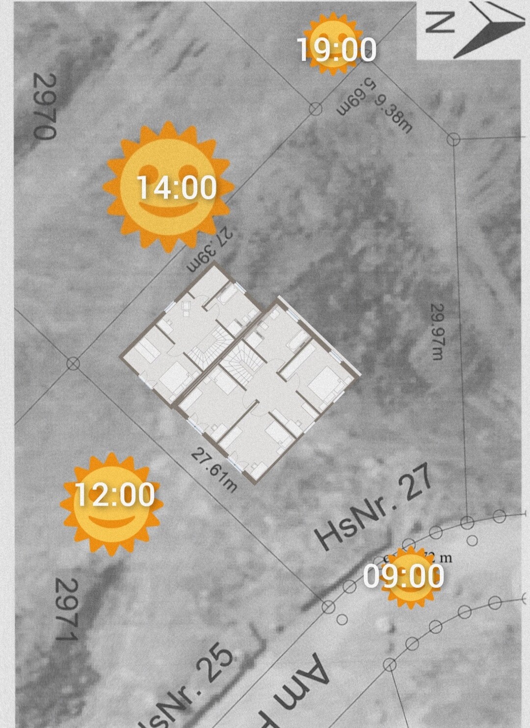

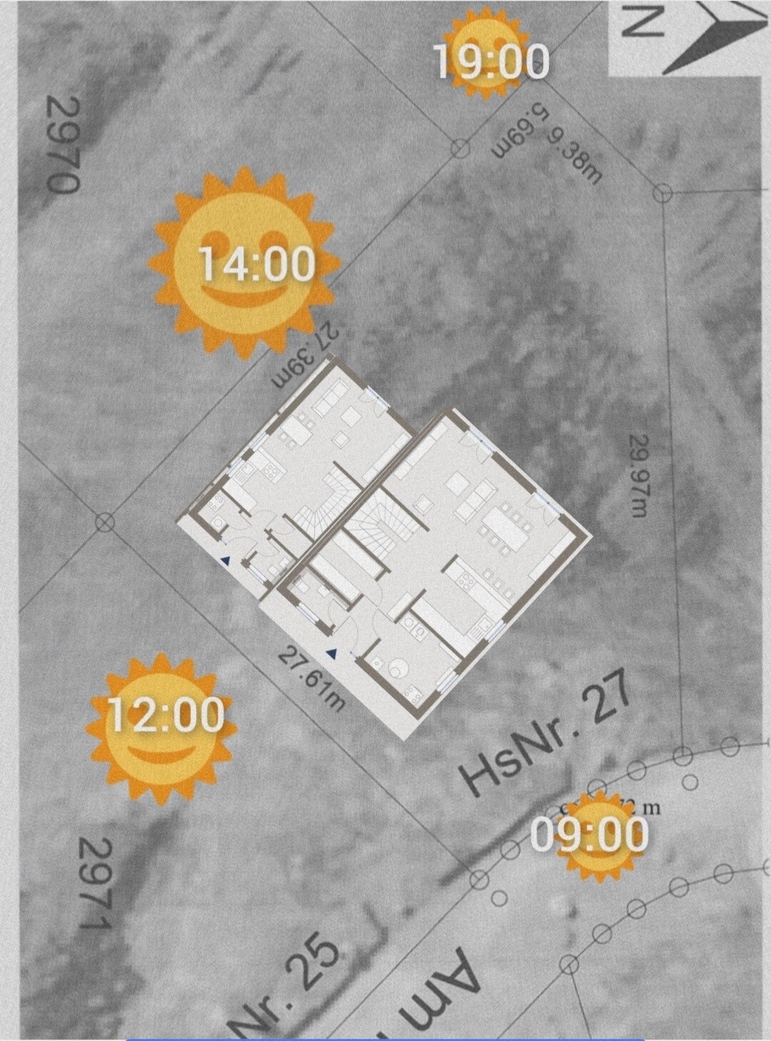

Am I imagining the whole thing correctly and advantageously?
House floor plan on site map with four sun symbols and times (09:00, 12:00, 14:00, 19:00).
Site plan with house floor plan and sun symbols with times (09:00, 12:00, 14:00, 19:00)

Thank you, but where could the garage be placed, and how would you get the car through? Also, I think having the house directly on the street is a bit of a disadvantage.

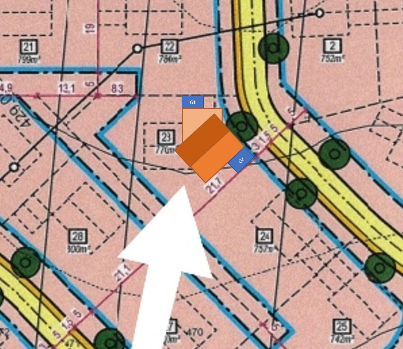

Thanks, but where could a garage be placed, and how would you access it by car? Also, I think having the house directly on the street is somewhat disadvantageous.
Map image with a large white arrow, orange squares, yellow road, and blue lines.
For example, like this (G1 and/or G2). By the way, the house is not directly on the street, but on the building line (blue line). This is probably about 3m (10 feet) away from the property boundary. And yes, it is quite common to place a house along one of the building lines, as it is the only way to create a usable garden on the other side of the property.
I can see from your sketches, for example in #21, that you lack basic approaches and experience in site placement, so once again I recommend “hire an architect!” The plot is too valuable for a carelessly placed, unsuitable standard house.
