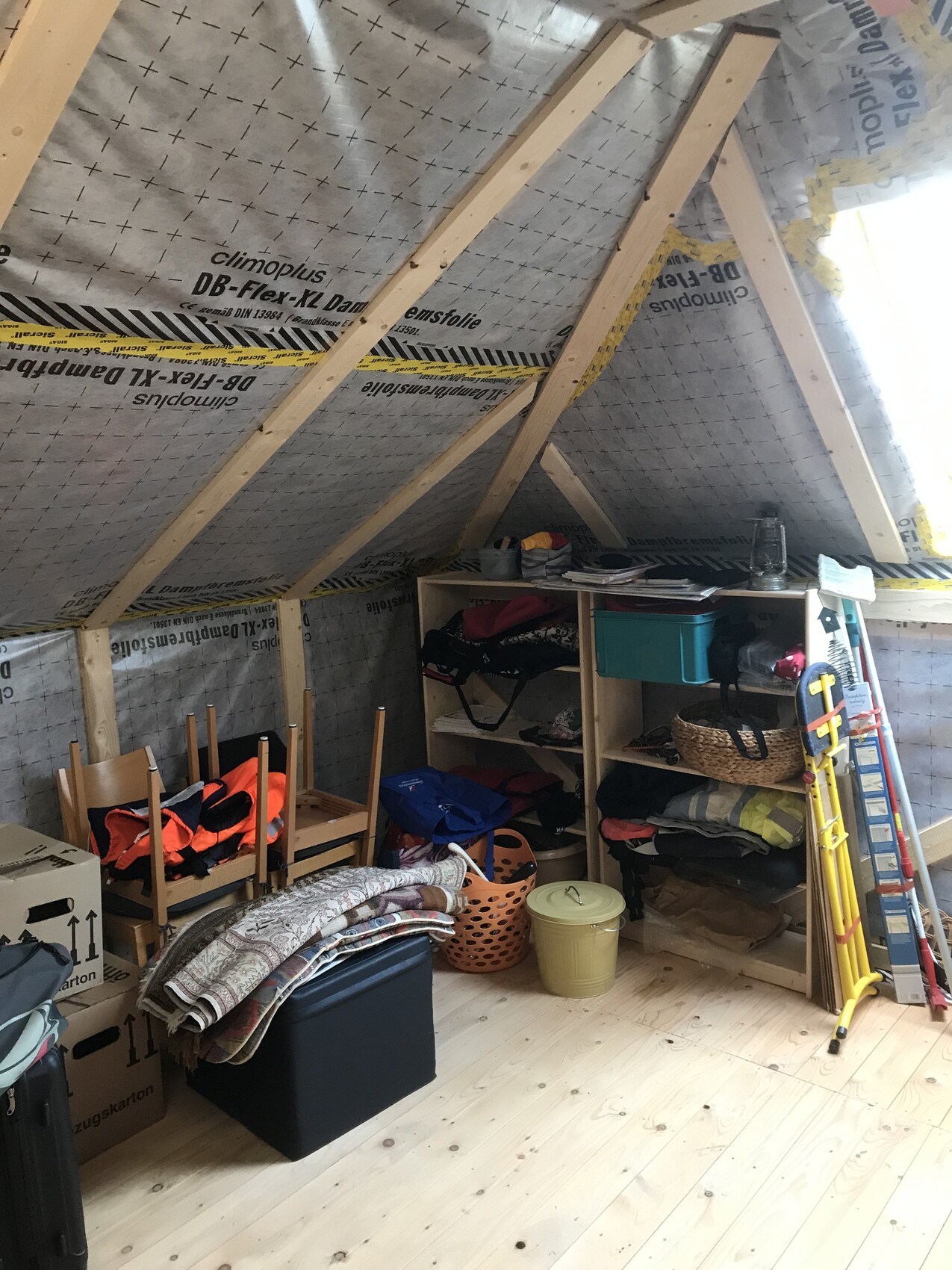

The general contractor insulated the ceiling with Knauf glass wool, thickness unknown. Later, I added Climowool 160 mm (6.3 inches) friction-fit insulation between the rafters along with a vapor control membrane. No moisture. Everything is dry. Now my model railway is set up on top, and it is not affected.
